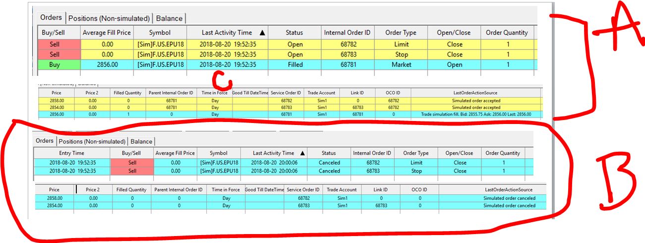

Morning, while running chart replay (over and over again without an issue), there became a time when the attached orders didn't attach, any thoughts? The attached orders go along fine for several trades during replay, then boom, an order is filled, without attached orders attached.

(UPDATE) closer examination -
the original attached order is being placed, but for some unknown reason, both 'target' and 'stop' are being removed from the original order, it appears to occur repeatably at specific time(s), 10's of attached orders go off without any issues, then at specific (repeatable) timestamp the bracket orders remove themselves, leaving the original order alone and lonely
now, i disabled the 'Trading System Based on Alert Condition', then manually placed the same order at the same time, and the manually placed order did not loose it's attached order
this is strange

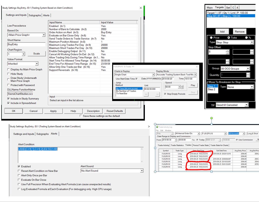

[2018-08-25 12:09:28]
User7817001 - Posts: 96
(UPDATE II) attached is the configuration I am back testing, it is necessary to attempt to duplicate this issue
the triggered trade timestamp is included 2018-08-20 19:52:35:018
the bracket orders go away a few minutes later 20:00:00
again, manually entering the bracket order does not exhibit the issue
this behavior exists at differing times during different chart lengths

[2018-08-26 12:56:21]
Thank you for the recommendations, please see attached for order details
a) original order
b) 'canceled' order (unknown reason, but repeatable)
c) odd, order type is 'Day', yet, TIF = Good Till Cancelled on the order menu
I do not know if there are other (overriding) TIF settings which are overriding the order menu...
imageCapture.JPG / V - Attached On 2018-08-26 12:48:54 UTC - Size: 131.06 KB - 543 views

[2018-08-27 08:39:12]
I am setting TIF on the right trade window, there is only one(1) trade window, there is only one (1) chart (55t) in the one (1) chartbook that is open during this backtesting.
There are two order menu tabs which contain TIF LOV (list of values, in case you didn't know that term) in the Trading Window attached to the one (1) chart that is open in the one (1) chartbook that is open. Both LOV's for TIF are set to "Good to Canceled", this configuration is saved. I also saved all, closed and reopened the single chartbook containing the single chart, to confirm the TIF LOV remained, it remained "Good to Canceled".
The trade activity log (which I provided a snip copy of last post) shows the order TIF was "Day", also it was "Canceled" at 19:52:35 (repeatably), I see no new information on the viewinghistoricalactivity page to root cause the issue. If there is a reason for the TIF to change from "Good to Canceled" to "Day" in the trade activity log, please direct me to where this exists.
I did more closely examine WHY after I set TIF to "Good to Canceled" this is changing BY ITSELF to "Day" when the order is placed using 'Trading System Based on Alert Condition' which I have used many times in the past without this issue.
1) TIF is changing (by itself) from 'Good to Canceled' to 'Day' using 'Trading System Based on Alert Condition', when the order is placed by the study only.
2) TIF is NOT changing when the order is manually placed (study disabled)
3) Bracket orders are not "Canceling" when TIF is 'Good to Canceled', during the manually placed order.
Mark
[2018-08-27 09:22:18]
Yes this is the problem. We need to look into this. We have to see if we can use the Trade Window to set the Time in Force. Clearly it is getting override by the study.
[2018-08-27 09:48:39]
This will be resolved in the next release (coming out in a day), and we have also added this section to document how it will work:
Trading System Based on Alert Condition: Time in Force
