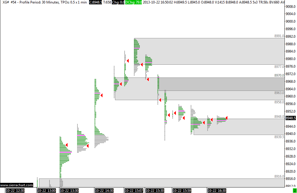

Hi all.This is my first post on this site. I have been with Sierra since January of this year.I currently have a problem with my drawing tool, the extending rectangle on my 30 min profile chart which is not good.This needs to be very accurate when I draw it as the rectangle is copied on to a lower time frame where it is used for important potential trade decisions.When I position my mouse pointer to the exact point where I wish to draw from & I click it is tending to jump away from this point & continues to do so when i drag it.When I drag it to the bottom of the profile where i want it to be latched to, it is again jumping away & I can't seem to accurately drag & latch it to the correct position.
Is this a pc problem at my end or could it possibly be a software issue?.

http://www.sierrachart.com/image.php?l=138245700594.png
The rectangle drawn at the top profile has latched correctly to the value area, where the one to the left has latched below & it wouldn't allow me to latch it to the bottom of the profile even when I tried to move it with the mouse it kept jumping above it & below it?.You can see i have had the same issues with the other rectangles, ie not being able to place them correctly & this isn't accurate enough for me with this type of profile trading where these levels are copied through onto a lower time frame & aren't currently accurate enough. Please help,
Kind regards
Karl.
[2013-10-23 01:17:42]
What we think is going on is you have enabled the automatic snapping of chart drawings. You need to disable this. Here is the documentation for this:
https://www.sierrachart.com/index.php?l=doc/doc_Tools.html#Snapping
