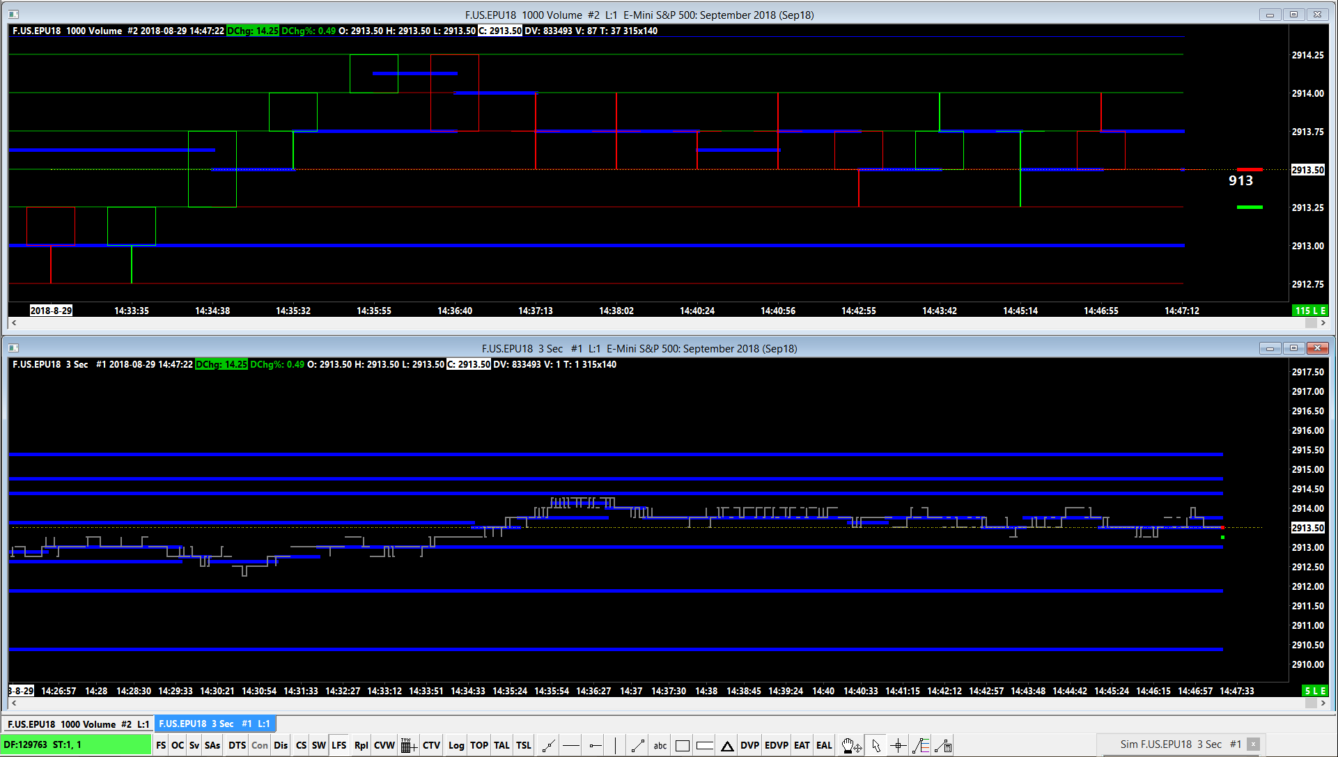

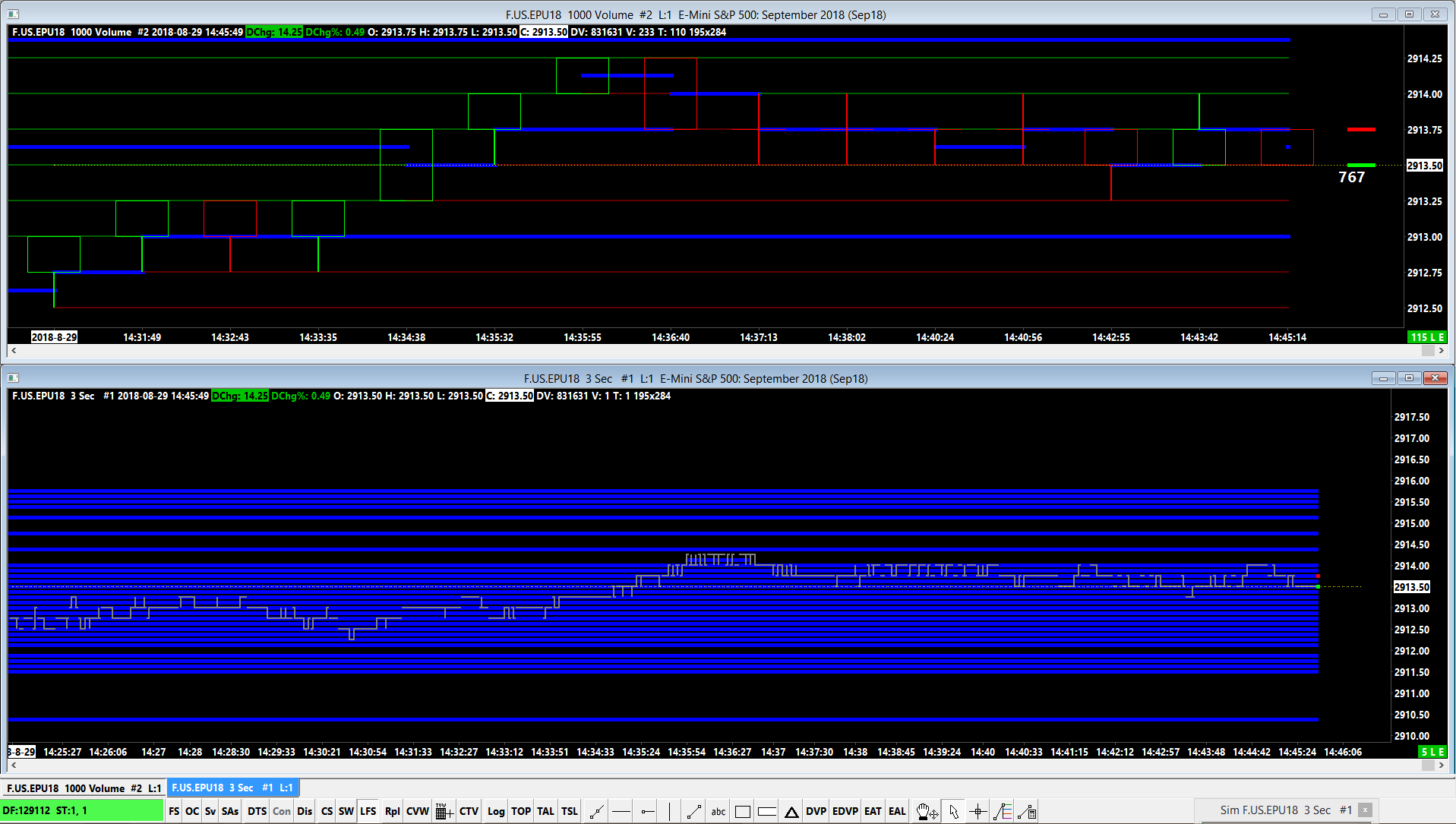

AndyBisulca - Posts: 22
I have attached 2 files for your review. The ES Before Reload file is the view of the chart with the incorrect extension lines. The ES After Reload file is the correct view of the extension lines after the chart data was reloaded.

Hey John. My SC version is 1785 64-bit. I can consistently reproduce the anomaly by letting the high time frame and low time frame charts run for 30 minutes or so (less if the market activity is busy). Take an image of the low time frame chart. Reload the low time frame chart (I type the time frame value in the chart and press enter to reload the chart data). Compare the before and after low time frame charts and you will see a reduction in the number of drawn extension lines. I hope this helps. Thanks, Andy.
