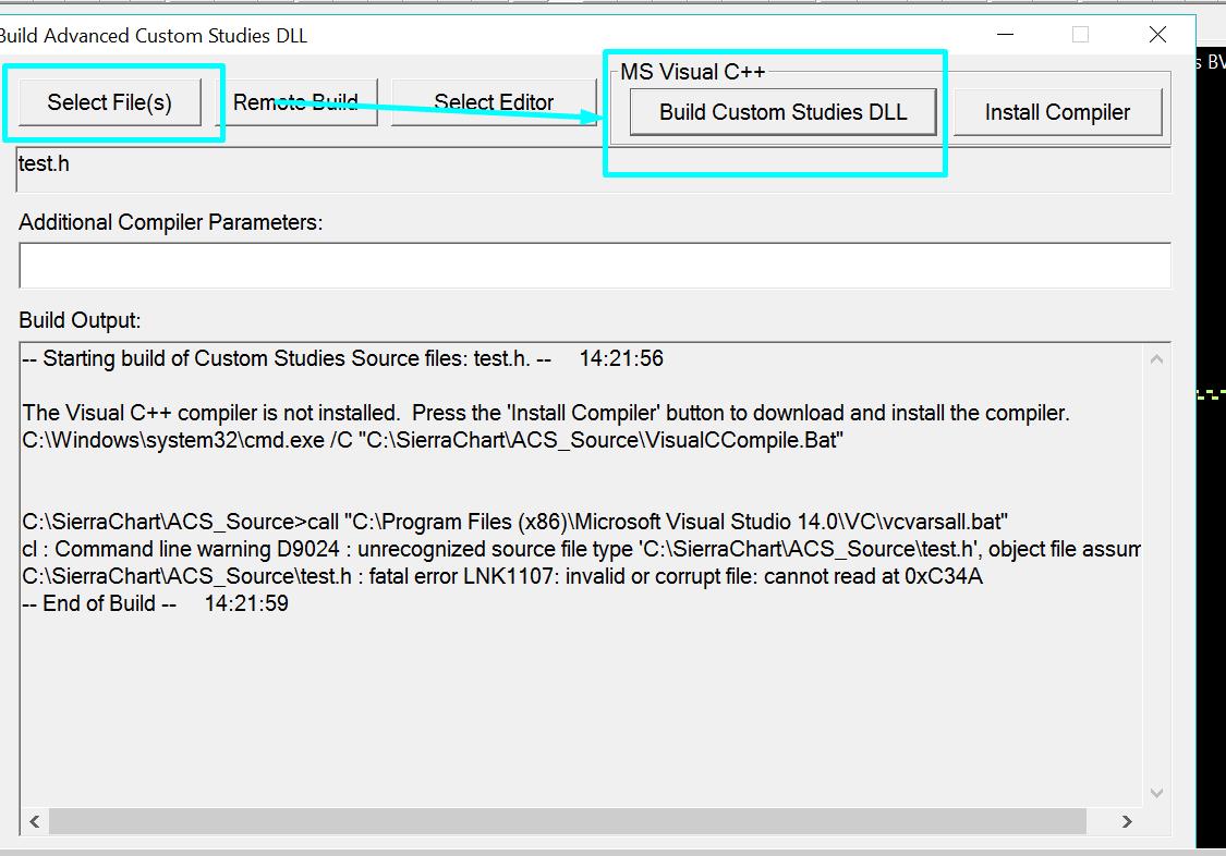

User271989 - Posts: 44
i get this error even bofere edit the cpp.

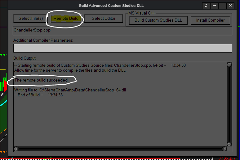

[2018-08-21 15:49:52]
Xfanman1 - Posts: 320
Try using the Remote Build to compile your .dll instead of the one you're attempting to use.

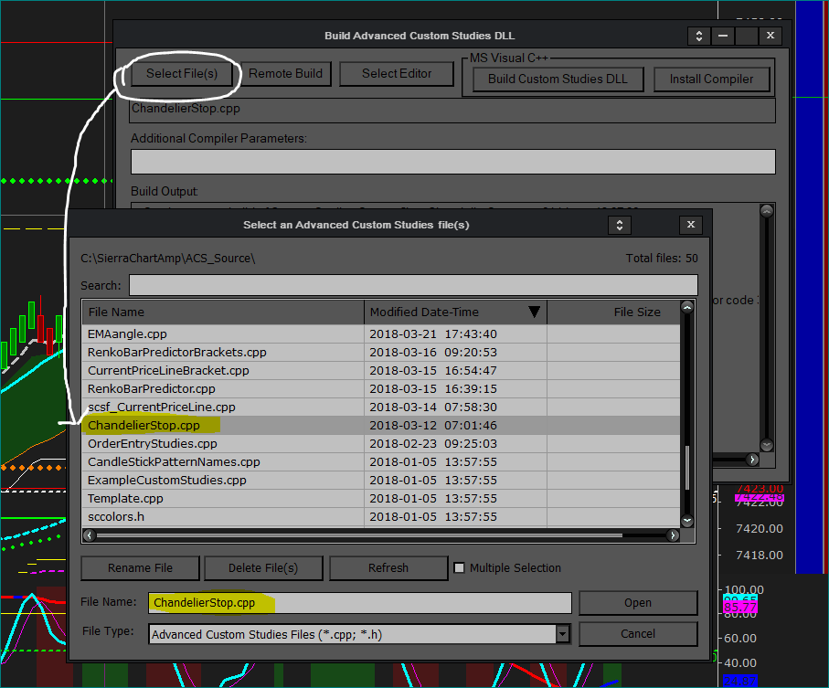

[2018-08-21 17:31:19]
Cavalry3162 - Posts: 523
you can not compile a header file into a dll.. choose the proper file (your .cpp file) when trying to compile
[2018-08-21 17:38:27]
Select your .cpp file as Andreas said above. Then select Remote Build and if your .cpp file is correct you'll get your .dll file built and added to your SC Data folder.

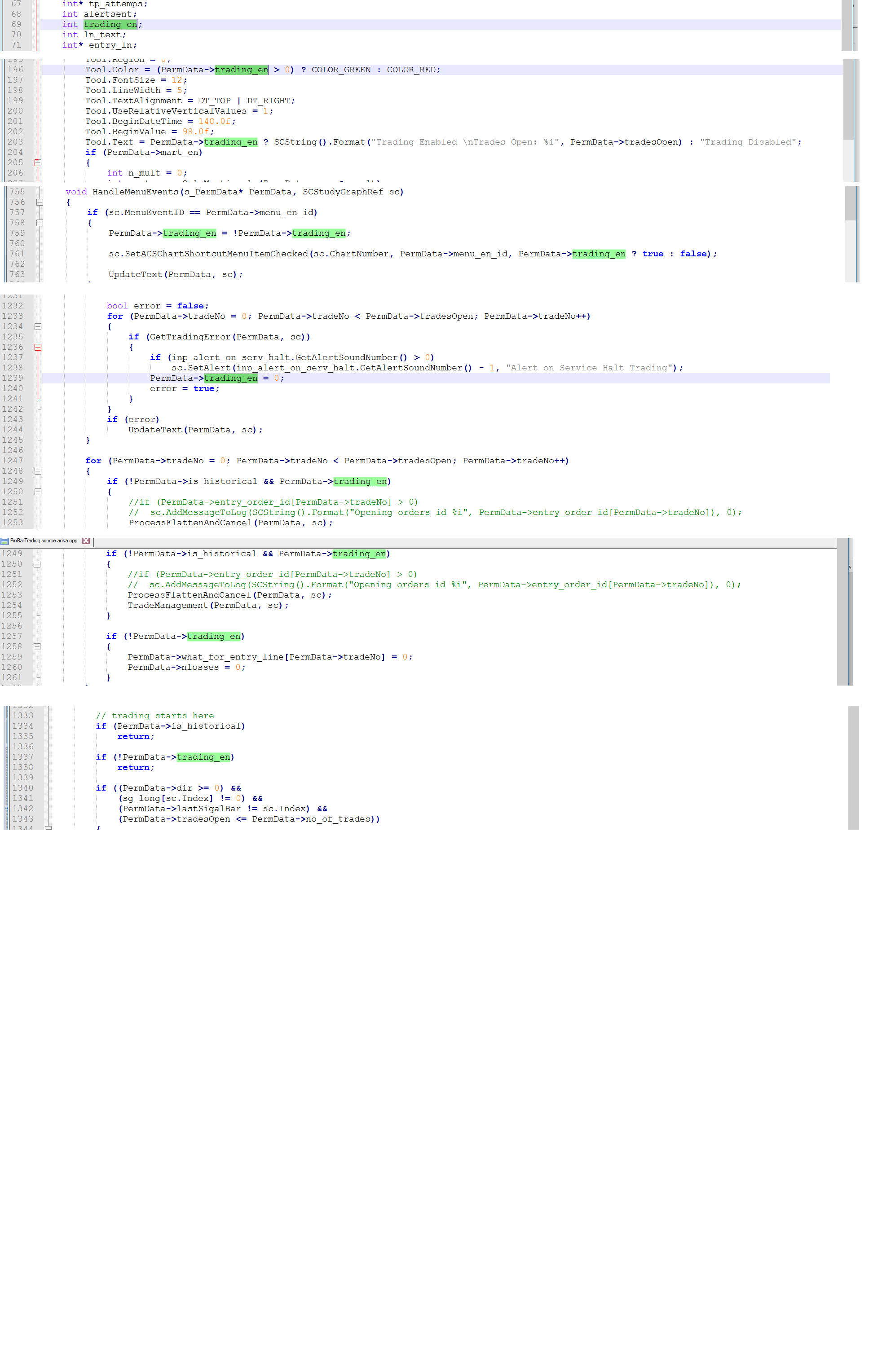

i will leave the strategy running but will explain here what i am trying to do so maybe all you can help me further
there something in this code wich disables trading everytime i get a error from the exchange
i wish to remove it
see the image, what i did now to test is simple delete line 1239 wich i believe is the part of code responsible for make the strategy turns off after receive a order rejection message
do you believe this is what is disabling the strategy?
delete only line 1239 is enough or should i delete all "traing_en" lines?
thanks in advance
