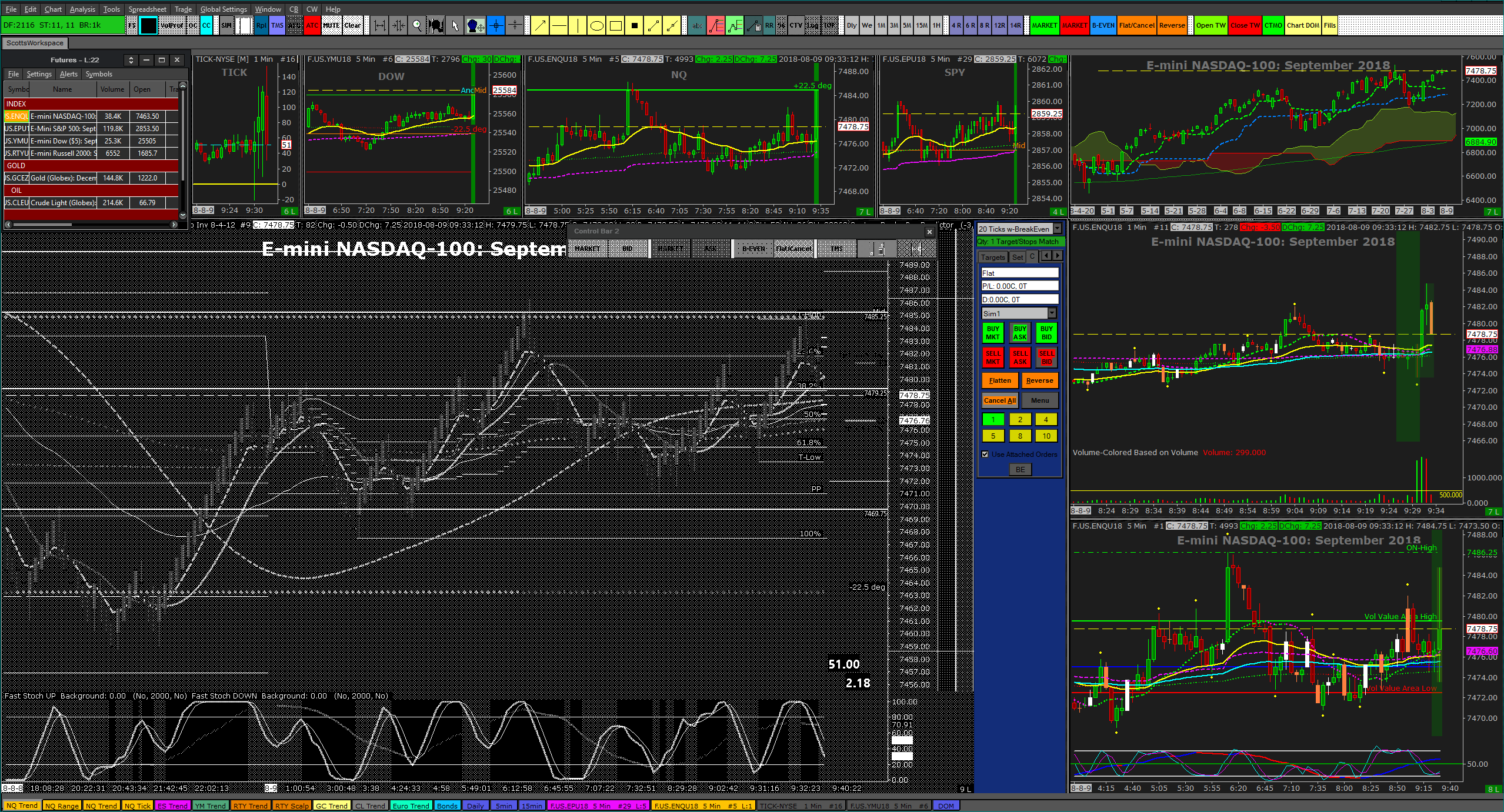

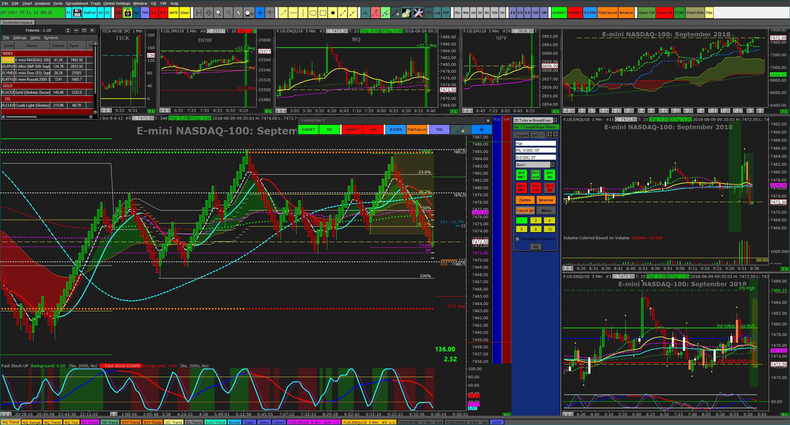

Just updated to the current pre-release on my main desktop machine (laptop was fine) and I was greeted with the first attachment. No color on my main charts. Other charts, just as normal. I restarted SC just in case it was an anomaly and same issue.
I then rolled back to 1786 and my platform is back to normal as in second attachment.
Any ideas?

image1787 Color Issue.PNG / V - Attached On 2018-08-09 13:39:10 UTC - Size: 309.4 KB - 612 views
image1786.PNG / V - Attached On 2018-08-09 13:39:18 UTC - Size: 348.17 KB - 545 views

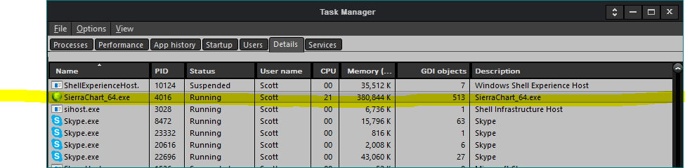

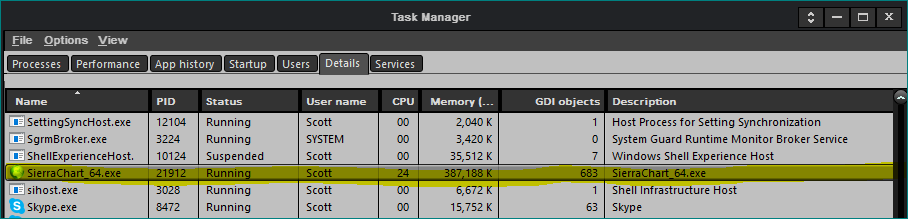

The GDI object counts for v1786 = 513 and for v1787 = 683. This is right after restarting SC for both version. I've attached images for both.

imageGDI Objects v1786.PNG / V - Attached On 2018-08-09 15:18:46 UTC - Size: 24.37 KB - 558 views
imageGDI Objects v1787.PNG / V - Attached On 2018-08-09 15:18:53 UTC - Size: 21.52 KB - 531 views

It kind of looks like the mix mode for the background is not correct. We will make sure that is properly set before drawing the background.

The higher GDI object count is not really unusual because of object caching in the newer version.

The reason for the problem has been determined and we will have a new release out by morning we expect. But could be a little longer.

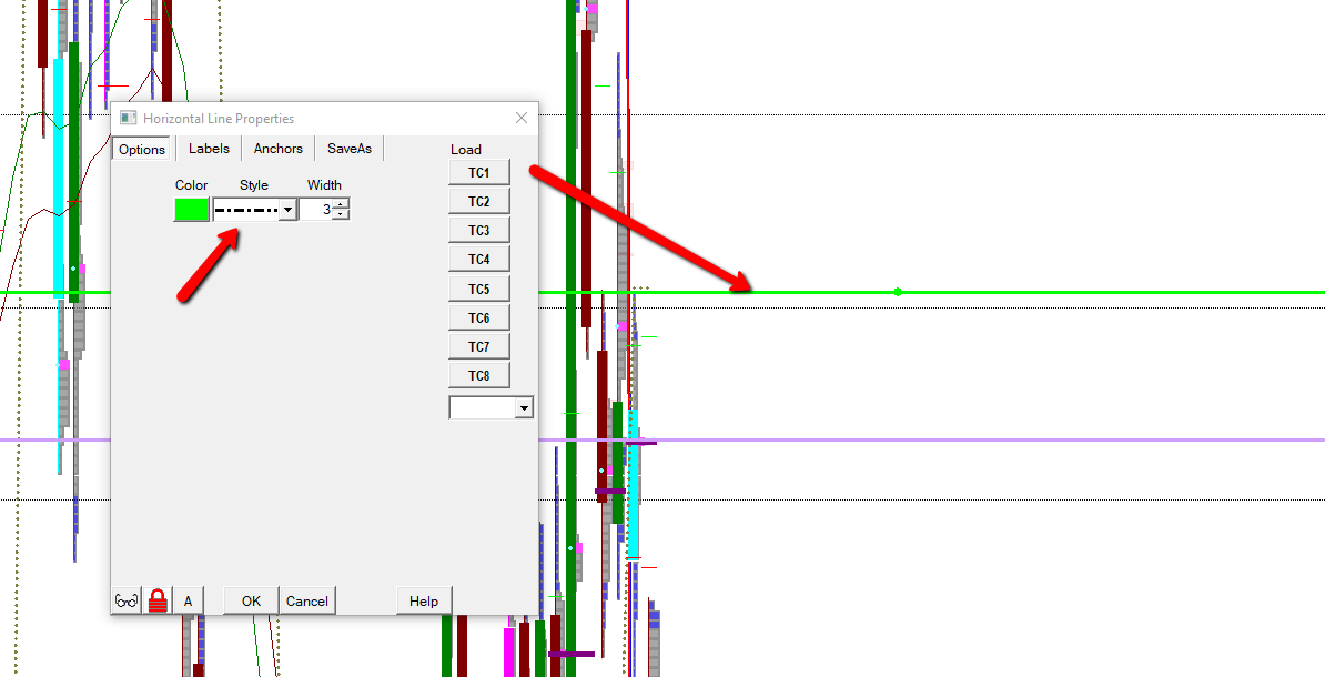

* Horizontal Lines (and maybe other objects but that's just what I first noticed) I've drawn on the Charts, will not display in anything other than a solid line. My default setting is a dashed line yet when placing a horizontal line it displays as a solid line. Selecting other line types still only displays a solid line on the chart. Lines that I had placed yesterday that were dashed are also now solid.

Version 1788 seems to have a similar drawings problem. Lines which should be "dash dot" lines, appear as solid lines
imageDash_dot_line_problem_2018-08-13_0553.png / V - Attached On 2018-08-13 05:04:22 UTC - Size: 42.37 KB - 561 views
[2018-08-13 06:18:44]
We are working on this now.

Are the horizontal line issues resolved in pre-release 1789?
Please advise
[2018-08-17 09:30:18]
Yes.
