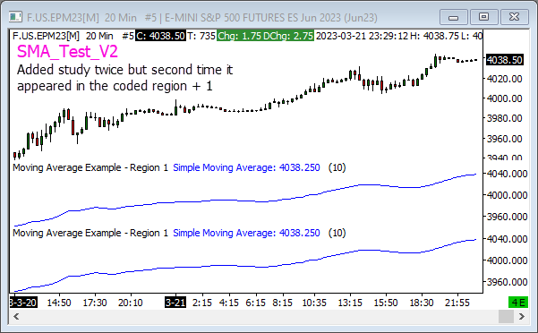

[2023-03-21 23:44:24]
User92573 - Posts: 622
Hi John
No its not working as described. Here are two versions of code, one setting the region inside the defaults and the other outside.
The regions are:
0 = Main Graph region or region 1 visually.
1 = Next region or actually region 2 visually etc etc.
When I place the study a second time irrespective of where I set the Regions it display in the next subgraph, not the same or designated. As usual its probably me but here is the code and screenshots related to V1 and V2.

2 Screen shots, one for each follow.
As always, many thanks for the support.
Date Time Of Last Edit: 2023-03-21 23:44:45
imageV1 study added twice.png / V - Attached On 2023-03-21 23:43:40 UTC - Size: 27.4 KB - 380 views
imageV2 study added twice.png / V - Attached On 2023-03-21 23:44:02 UTC - Size: 27.52 KB - 368 views
[2023-03-22 14:29:10]
Your Version 1 will not do what you want, you would need to use Version 2.
When we copy and compile your Version 2, it works as we expect. It will only allow the study to be put into Region #2 (sc.GraphRegion = 1). When we try to change the region, it forces it back to 2. When we add 2 copies of the study, they are both drawn in the same region (verified by changing the color and size of the lines).
We do not know why this is not working for you. Your version 2 should only draw that study into Region #2 as you have it defined.
