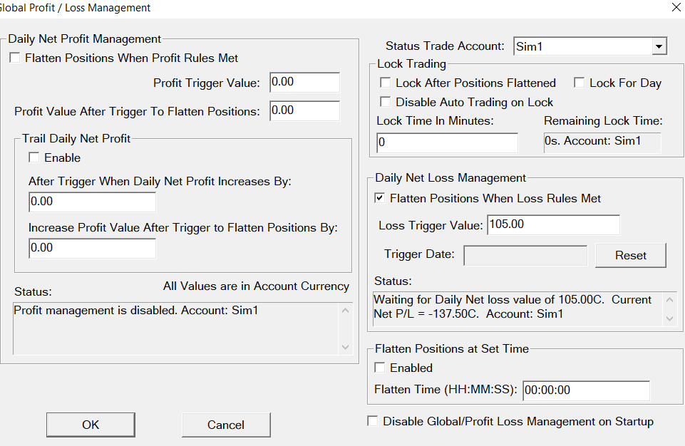

I've been testing it on Sim today. See encl. Loss limit was set to $105. Current Open P&L loss is $137.50 It seems it is not using Open P&L.
Please resolve.

The Loss Trigger Value needs to be negative as the documentation explains.

Post #6 does not mean much to us because we do not know exactly what you are doing. And the documentation is very very clear on how this functionality works. It certainly does use both the Closed Profit/Loss and the Open Profit/Loss for the trade account. But there can certainly be calculation errors with both of these due to the underlying data available to Sierra Chart. Update to the latest release to make sure that position average price is properly determined when using CQG under all conditions.
It sounds like you probably want to use the Profit Management. In addition to Loss management. Refer to:
Global Profit/Loss Management: Daily Net Profit Management
If the functionality does not work properly for you, then do not use it. It does work properly as designed and it is well documented.
We do not want to hear further about this.
