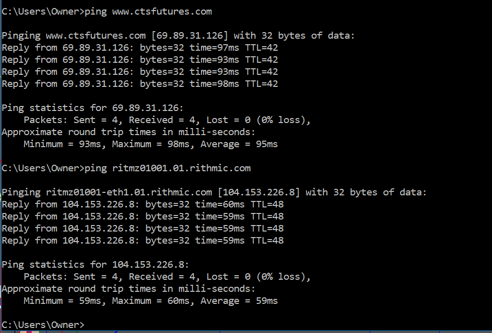

RAN A PING TEST FOR BOTH, WHAT DO YOU THINK?
imagepinging cts vs rithmic.PNG / V - Attached On 2018-08-09 02:52:54 UTC - Size: 52.36 KB - 595 views
[2018-08-09 05:23:21]
You really need to ping DS1.SierraCharts.com. And ultimately what counts is the connectivity we have to CTS and to the exchange. Both of those are very low latency. Not what you see on your side.
