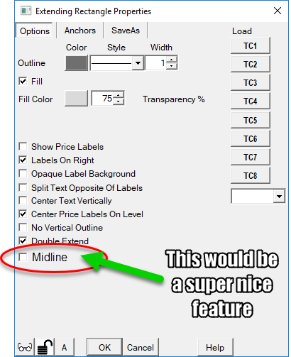

Hi Team,
can you add a function to display a Midline with the Extended Rectangle tool.
This would be super cool.
Thank you
image21-07-_2018_14-31-04.png / V - Attached On 2018-07-21 12:38:00 UTC - Size: 36.12 KB - 574 views

John - SC Support - Posts: 48548
We will look into adding this. But it will probably be a few weeks before we can get to it.
In the meantime, you can use the Spreadsheet Formula study to produce the Midline for you. The formula would look like the following =(UDID[9].A1 + UDID[9].A2)/2, with the ID of the specific drawing in place of the 9 in this case. Refer to the following documentation for how to reference Chart Drawings (this also applies to the Spreadsheet Formula):
http://www.sierrachart.com/index.php?page=doc/StudyChartAlertsAndScanning.php#ReferencingChartDrawings
Just for completeness, the documentation for the Spreadsheet Formula can be found here:
Spreadsheet Formula
You can control the length of the Midline by changing the setting of the Number of Bars to Calculate.
Sorry for how long it has taken us to get to this. We have just been busy with lots of things.
This ability has been added and will be available in release 1844. On the Configuration/Properties pages for Rectangle, Extending Rectangle, and Ellipse there is an option for Draw Midline. This midline uses the same settings as the outer lines.
