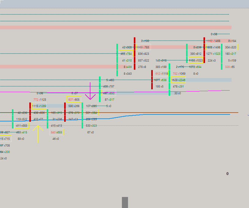

for an advanced study I need to draw 1 or 2 lines until further intersection within manual looping in an numbers bar chart.
Sometimes I need to draw a line on the top and the bottom of an chart, each one as single works but if I try to draw both, then only the last function call draws a line. I attached an chart showing the problem, only the upper line is drawn.
I isolated the code and the goal is to draw both lines, what's wrong in my code?
Mario

imagechart.png / V - Attached On 2018-07-19 15:30:40 UTC - Size: 24.64 KB - 377 views

The LineIDForBar parameter must be unique for each line of the same chart bar index. These should not be separate variables:
int &LongIndex = sc.GetPersistentInt(0);
int &ShortIndex = sc.GetPersistentInt(1);

Oh, interesting and it works
Thank you
