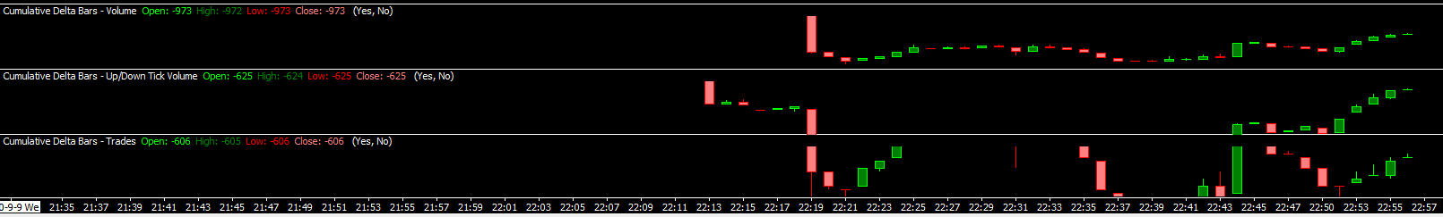

I have a similar problem. On all three of the cumulative delta bars studies, the open/close volumes can be the same, yet the candles are drawn as red or green candles, implying that the open/close volumes are different. Please see attached image - on the last bar, the volume is shown for open/close as being equal, yet the candle is being drawn as a green candle. This is true for all three studies.

Sawtooth - Posts: 4361
When the open equals the close, and the open is greater than the previous close, the bar retains the color of the previous bar.
This formula exemplifies how bars are colored:
=IF(OR(C>O,AND(O>C[-1],O=C)), then green, else IF(OR(C<O,AND(O<C[-1],O=C)), then red, else retain previous color))
[2020-09-10 13:58:33]
Ed C. - Posts: 128
Thanks, Tom! That clears things up a bit.
[2020-09-10 14:52:22]
You can color the bar a 3rd color when the open equals the close using the Color Bar Based On Alert Condition study, with a formula like this on the Alerts tab:
=ID1.SG1=ID1.SG4
-where the cumulative delta study is ID1.
