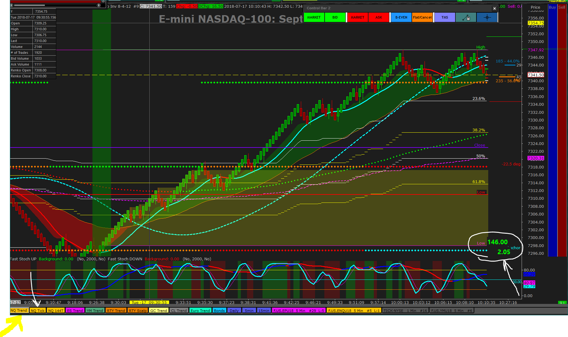

Xfanman1 - Posts: 320
In case there's some confusion by your use of the word "open" and you really mean not the active tab, I'm pretty sure you can do what you want without the referenced time frame chart being the active chart tab on your chartbook (assuming you don't have the Destroy Chart When Hidden feature turned on). I do this with multiple charts referencing tick data from other charts on my Renko charts.

When you say "Hidden" maybe we're talking about different things but, attached is an example of my NQ Trend Chart in the lower left tab. The data I circled in the lower right corner of the chart is coming from studies and calculations from the chart next to it on the NQ Tick chart. The NQ Tick Chart is NOT displayed, it is hidden behind this active chart until I click on its tab. I've also overlaid different time frame charts as Moving Averages on this chart from other charts that were not displayed. If that's not it, I'll drop it from here ;^)
