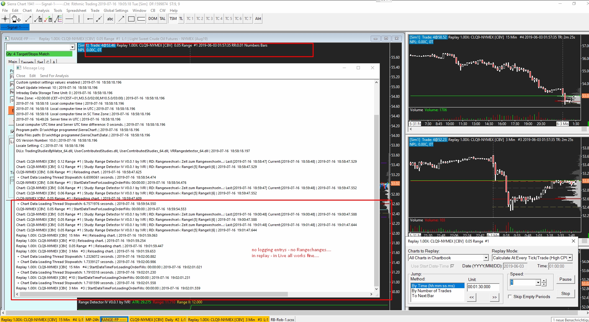

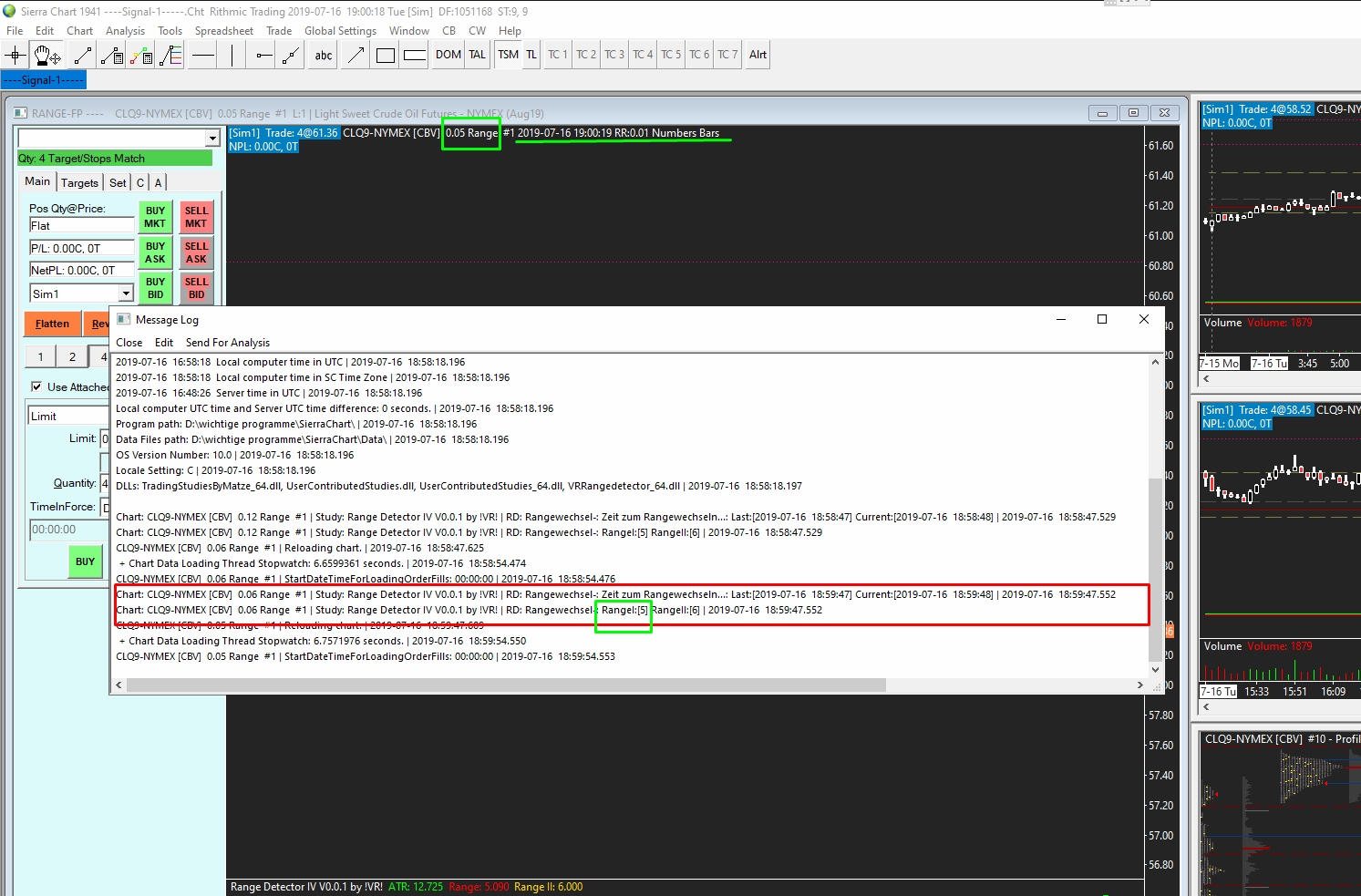

User681685 - Posts: 12
Hi... I used the same code:
sc.GetBarPeriodParameters(NewBarPeriod);
NewBarPeriod.IntradayChartBarPeriodType = IBPT_RANGE_IN_TICKS_STANDARD;
if (NewBarPeriod.IntradayChartBarPeriodParameter1 != r1)
NewBarPeriod.IntradayChartBarPeriodParameter1 = r1;
sc.SetBarPeriodParameters(NewBarPeriod);
in Live it works fine, but not in Replay. Do you know wy?
imagesr1.jpg / V - Attached On 2019-07-16 17:39:18 UTC - Size: 661.67 KB - 501 views
imagesr3.jpg / V - Attached On 2019-07-16 17:39:26 UTC - Size: 1.15 MB - 517 views
[2019-07-16 21:35:39]
Increase the replay speed so there is some activity in the chart so the study function is called. Maybe that is the problem.
[2019-07-18 06:49:35]
hi...
this does not solve the problem.
ist there a restriction regarding linking charts? here is my compleet code attached...

hi... Thank yuo for the code. I Find the Problem now. but i dont know what is wrong. The Problem is in this case....
SCDateTime& pLastCalculationDateTime = sc.GetPersistentSCDateTime(50);
SCDateTime& pLastRangeChangeDateTime = sc.GetPersistentSCDateTime(51);
if (CurrentDateTime - pLastRangeChangeDateTime > (Input_ChTime.GetInt() * SECONDS))
//calculation and Range-Change....
pLastCalculationDateTime = CurrentDateTime;
when i make the Time-questions extract from code, then it works on replay to, with... only in realtime...
can you help me?

[2019-07-18 10:52:35]
... I see the pLastRangeChangeDateTime contains the Last Time from Real....
in Replay to.... is ther a way to reset it only on entry in Replay mode?

[2019-07-28 16:54:45]
hi... i find it....
if (sc.IsReplayRunning())
CurrentDateTime = sc.CurrentDateTimeForReplay;
else
CurrentDateTime = sc.CurrentSystemDateTime;
Thanks. its solved...
