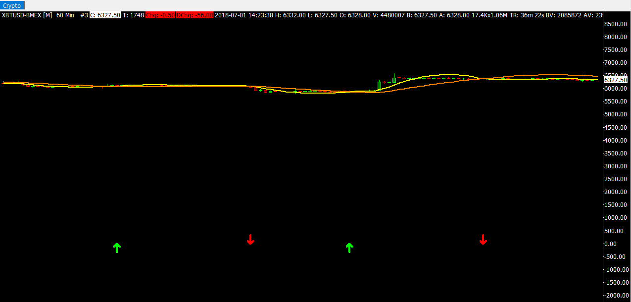

I compiled this example Example ACSIL Trading Systems
it worked and the dots for the signals where displayed as expected (above/below the candle bars).
When I changed the Drawstyle (in the study setup) from POINT_ON_LOW (long)/POINT_ON_HIGH(short) to be Arrow Up/Arrow Down, the result was a total offset of the drawstyle like it got scaled on another chart as you can see in the attached screenshot.
pls advice.
thanks

[2018-07-04 21:57:45]
When using other Subgraph Draw Styles you need to set the value you want the Subgraph to display at, at the chart bar column index with that Subgraph. So you need to set it to either the bar high or low price.
Date Time Of Last Edit: 2018-07-04 21:58:28

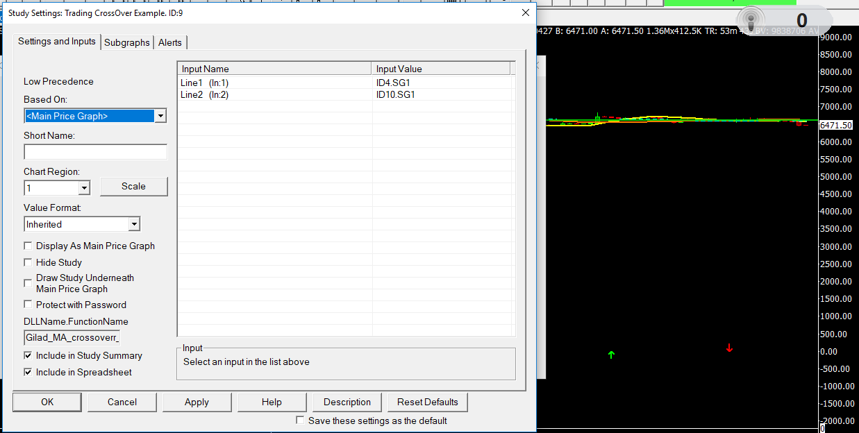

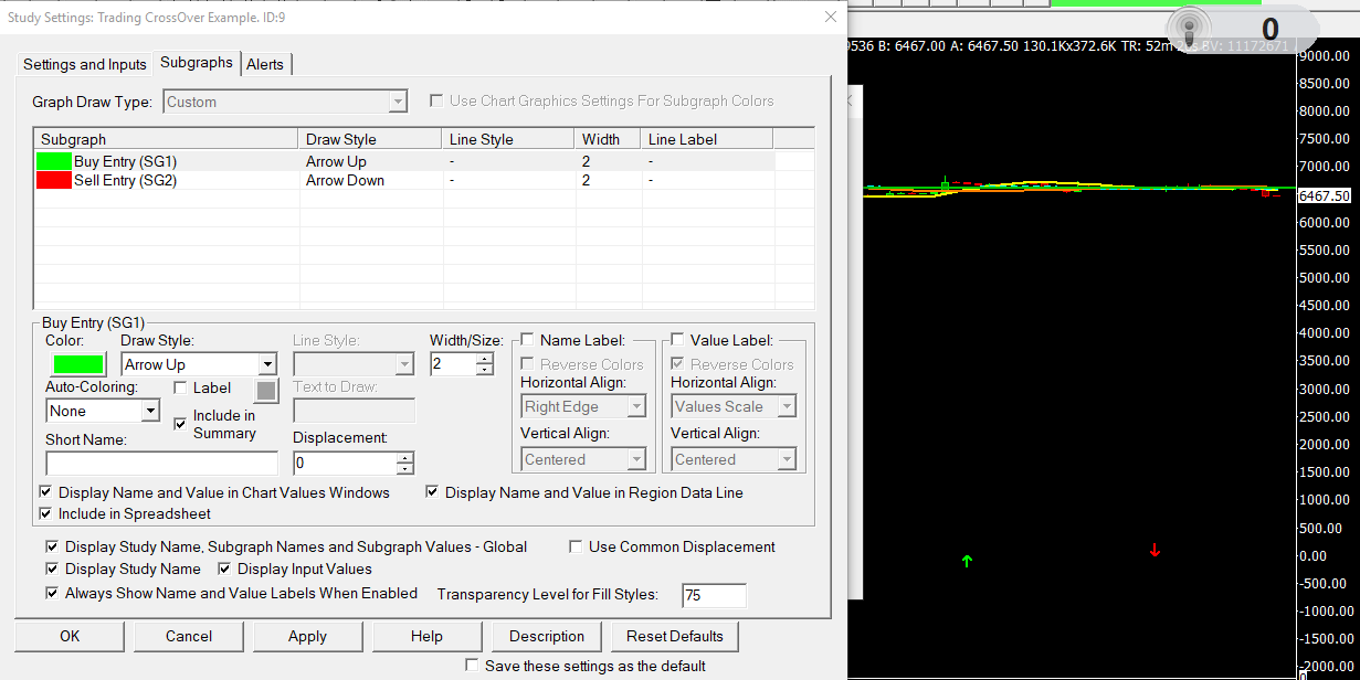

User61576 - Posts: 458
pls check my setup
and let me know what i am doing wrong
thanks

[2018-07-05 19:26:08]
We updated the code on this page so this problem will not occur:
Use the updated code.
Date Time Of Last Edit: 2018-07-05 19:26:23

[2018-07-06 09:27:03]
We changed this line to include the actual price level where the subgraph draw style should be displayed:
Subgraph_BuyEntry[sc.Index] = sc.Low[sc.Index];
