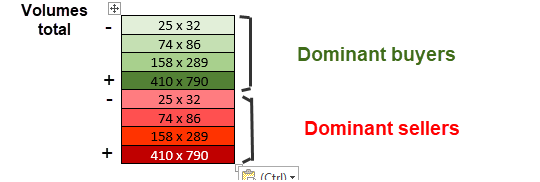

I read the user manuel, but I can not find a response to my question, perhaps you have the solution ?
I would like to have a method of coloring for each price (each level of price with two parameters :
1) choice of color for all the price level based on dominant side (for example green for buyers dominants and red for sellers dominants);
2) shading of the color (red or green) based on total volume (buy + sell) at each price, more total volume = the darker the color with several shading of color, at least four

imageCapture.png / V - Attached On 2018-06-26 11:14:58 UTC - Size: 13.07 KB - 721 views

That I say is perfectly illustrated by the file joined to my post named Capture.png, have see it ?
The background coloring method (green ou red) is based to dominant side (bid, ask), not for the total footprint (or bar) but at each price level : so we can easily and very quickly see who does what, who is at the maneuver.
The shading of color define above (red light to to red dark or green light to green dark) is based on the relative volume at each price (darker )= more volume at this price compared to volumes traded at other price levels in the bar or footprint)
I hope it's more clear, sorry if I'm not clear enough
Have a good day

Relative volume : Volume at each level shading (dark to liht) is relative to the total volume of the bar footprint
