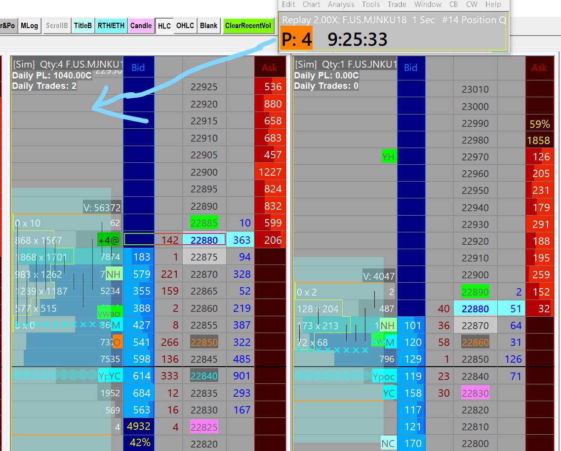

YK - Posts: 33
When the price far away from my position, then I can not see my position.
Please see the attached image.
Date Time Of Last Edit: 2018-06-24 07:04:27
imageInkedcurrentposition_LI.jpg / V - Attached On 2018-06-24 07:02:49 UTC - Size: 1.18 MB - 1005 views
[2018-06-24 08:01:36]
@sstfrederik - Posts: 413
You won't be getting an answer from SC on this as it is marked a user discussion.
You can add a custom study and use the "Text display for Study" from the list in "Sierra chart custom studies and examples"
Check the documentation snippet here:
Chart Trading and the Chart DOM: Adding Studies on a Trade DOM
as a side note: position is already visible in yr pic. as +4@. on current price.

YK - Posts: 33
Frederik
Thank you for your advice.
Now I can show my position on the DOM.
Very appreciated.
