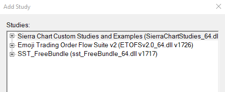

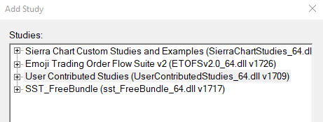

I am running 3 instances and I noticed that user contributed studies aren't showing on the 2nd and 3rd instance. What needs to be done to get these to show? Attached are images.
imagePrimary Instance.png / V - Attached On 2018-06-11 16:27:45 UTC - Size: 7.69 KB - 471 views
imageInstance 2-3.png / V - Attached On 2018-06-11 16:27:52 UTC - Size: 6.29 KB - 366 views

[2018-06-11 17:48:42]
TSiSVT - Posts: 21
I solved the issue by manually copying the UserContributedStudies_64.dll file and pasting into each of the additional instance's data folders.
I did download the current version (was on prerelease) but the file didn't populate in the additional instance's data folders.
