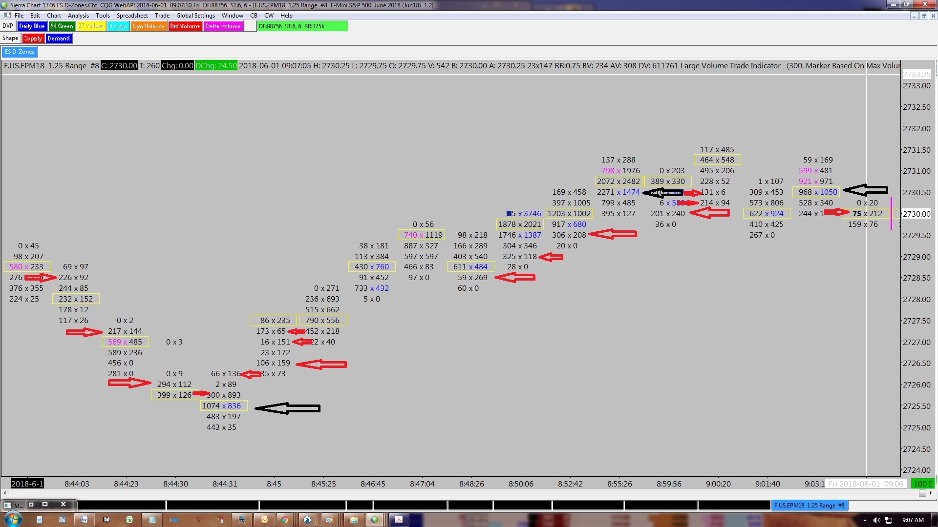

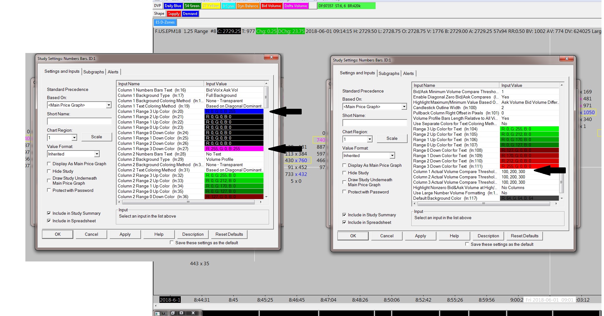

I attached a screenshot (the 1st one))that shows the setting being used in the Numbers Bar Study using 1.25 Range bars.
In the Numbers bar Study, the setting I only what to show the highest BidxAsk (In.20 & In.27) set to 3 times (In.112) on the way UP and the highest AskxBid on the way DOWN.
On the 2nd screenshot, the Black arrows shows numbers that should NOT be highlighted and the Red arrows shows numbers that Should be highlighted.

Also,
I set the "Pullback Column Right Offset in Pixels" (In.101) to "50". When the next bars opens, only half of the pullback Column is displayed.

The first thing we need is to understand exactly what you want to accomplish. From there, we can help you setup the chart using the correct settings for the Numbers Bars. Keep in mind, the Numbers Bars does have a lot of Inputs that can change how things are displayed, so we need very precise information on what you want to see.
With regards to the Pullback Column moving off the end of the chart, you can use the option to Lock the Fill Space, which will help with this. You can find the documentation here:
Chart Settings: Lock Fill Space (Chart >> Chart Settings >> Display >> Chart Display Items menu)

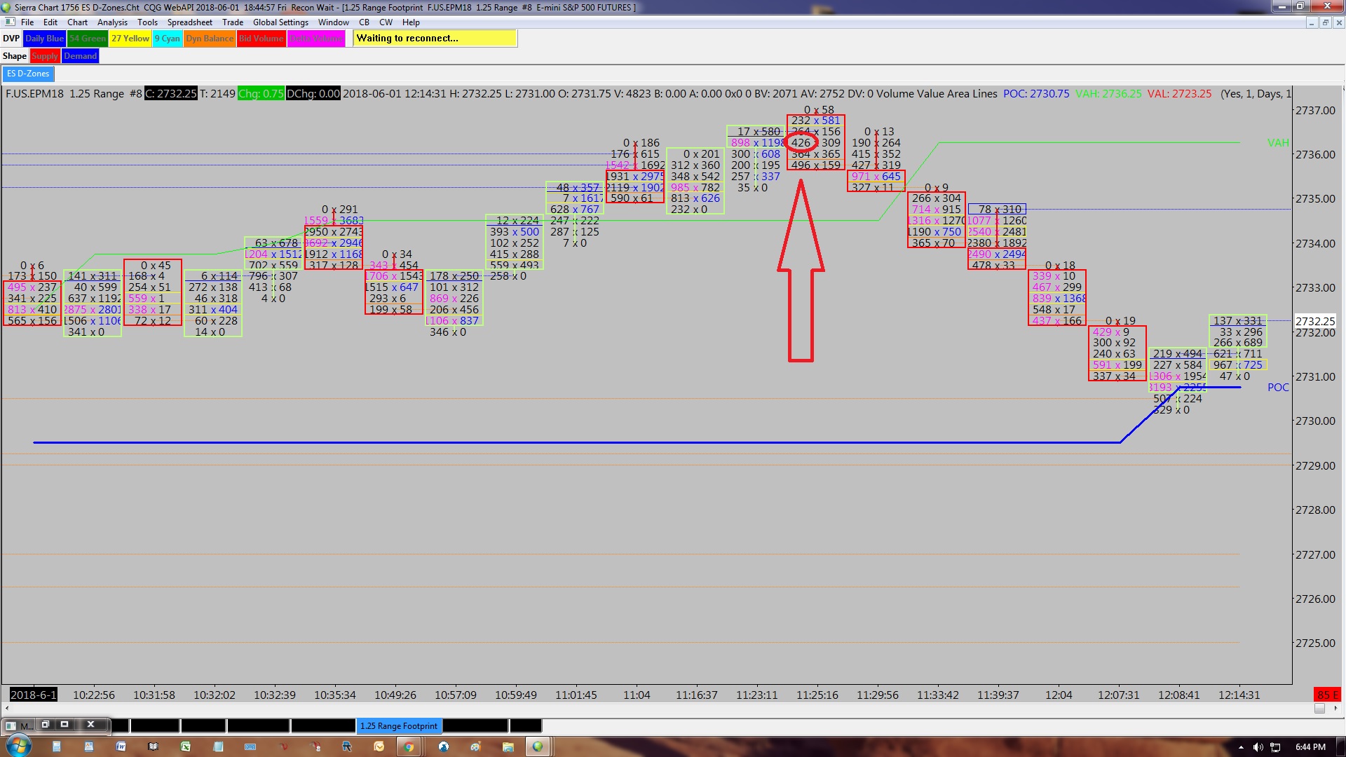

Ok, I think it is simply idea but maybe not so simple to implement
On a ES chart.
Using a 5 range bar chart.
Condition:
The previous bar closed down.
Then on the next bar, (up bar) the ASK volume is 3 times greater that the bid volume, the ask text colour will be highlighted BLUE.
The reverse for an BID colour.
The previous bar closed up.
Then on the next bar, (down bar) the bid volume is 3 times greater that the ask volume, the bid text colour will be highlighted RED.
I would like to put this together with a condition:
that this will only occur
- if the range bar CROSSFROMABOVE the daily VAL for a blue text highlight and
- if the range bar CROSSFROMBELOW the daily VAH for a RED text highlight
I hope this makes sense.
I attached a screenshot for a reverse for an BID colour.
Regards,
Daniel

You cannot do what you are trying to accomplish with the Numbers Bars study.
You can highlight the Main Price Graph bars (not Numbers bars) to a specific color when your conditions are met. To do this, use the following study:
Color Bar Based on Alert Condition
