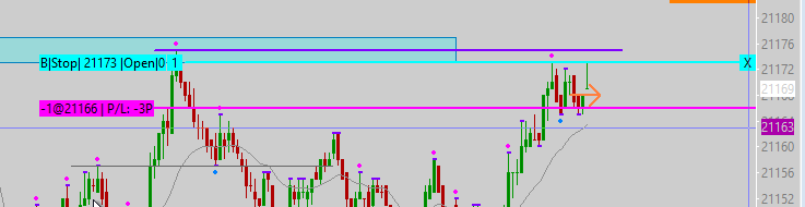

[2018-06-06 00:01:05]
User459170 - Posts: 262
Please see attached chart. Its a 1 min chart of YM on 6th June 2017 YM data. buy stop loss at 21173, price touched 21173 and is coming down, but as you can see order has not triggered.The bar that touch 21173 but didnt trigger SL is at 8.50 a.m PST
Attached also is the replay configuration
Date Time Of Last Edit: 2018-06-06 00:03:13
imagesi.png / V - Attached On 2018-06-05 23:59:31 UTC - Size: 6.62 KB - 442 views
imagesi1.png / V - Attached On 2018-06-06 00:00:06 UTC - Size: 8.34 KB - 572 views

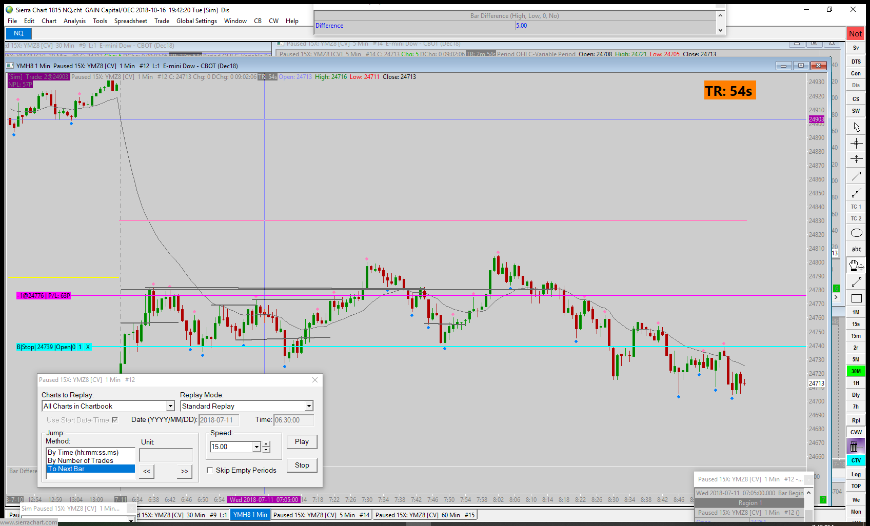

[2018-10-17 01:33:37]
Hi, will you be able to do this with remote assistance now if possible. This is on my backtesting screen now. I have updated my tel no.
Hi, I am going to have to continue with my backtesting, looks like you guys are not here, anyway, heres the screenshot.
http://www.sierrachart.com/image.php?Image=1539744142717.png
Price has touched 24739 but order has not triggered.
