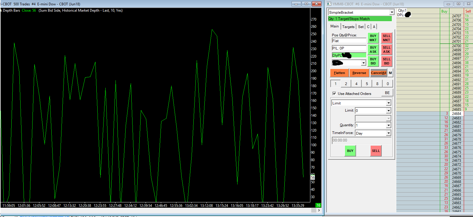

I'm comparing Bid & Ask Depth Bars with the DOM's orders, and I see that there is a difference between them.The settings are (Sum Bid side. Historical Market Depth- Last,10).Is this calculation sum to the last 10 levels of the DOM?
In the image the indicator Bid & Ask Depth Bars shows 56 and the sum of the last 10 bid sides of the DOM is 213,why this difference?I'm attaching the image.

[2018-05-31 22:43:30]
John - SC Support - Posts: 48028
There are some changes we are making in order to make these calculations more consistent and match to the data that is seen. We expect to have these changes in the next update.
We have made the changes so that when using the Historical Market Depth - Last or Max, it will only use the data that is from the Best Bid and below or from the Best Ask and Above.

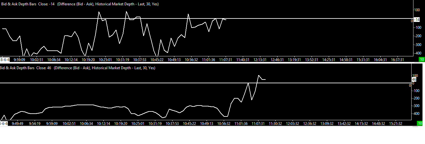

there seems to be some error, because after half an hour all previous values have changed.Did not you realize that?
[2018-06-06 14:40:00]

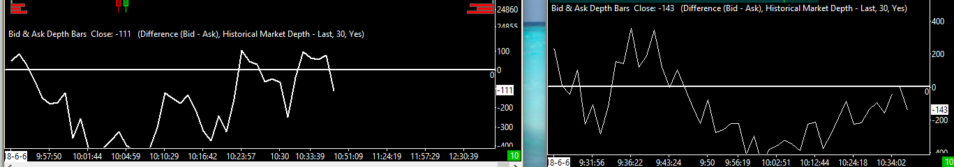

02108 - Posts: 28
and now the chart of 500 tick from the left is different from the chart of 13 range from the right.
imageCapturar.PNG / V - Attached On 2018-06-06 14:39:53 UTC - Size: 46.11 KB - 603 views
[2018-06-06 15:14:08]
02108 - Posts: 28
I got a screenshot of the situation of the values change,you may realize that after some time the values change,is the same chart, only a few minutes later.it looks like it's getting more negative
Date Time Of Last Edit: 2018-06-06 15:15:03
imageCapturar.PNG / V - Attached On 2018-06-06 15:14:02 UTC - Size: 23.05 KB - 552 views
[2018-06-06 21:22:03]
We will look this over.

We are unable to reproduce the problem you are seeing with the Bid and Ask Depth Bars getting more negative. We let the study run for over an hour and the previous data (not the current bar) remained stable over all that time. We used the same settings that you had in the image supplied.
Therefore, can you please attach the Chartbook that is showing this problem. You can post the Chartbook using the instructions found here:
Date Time Of Last Edit: 2018-06-15 20:18:59
