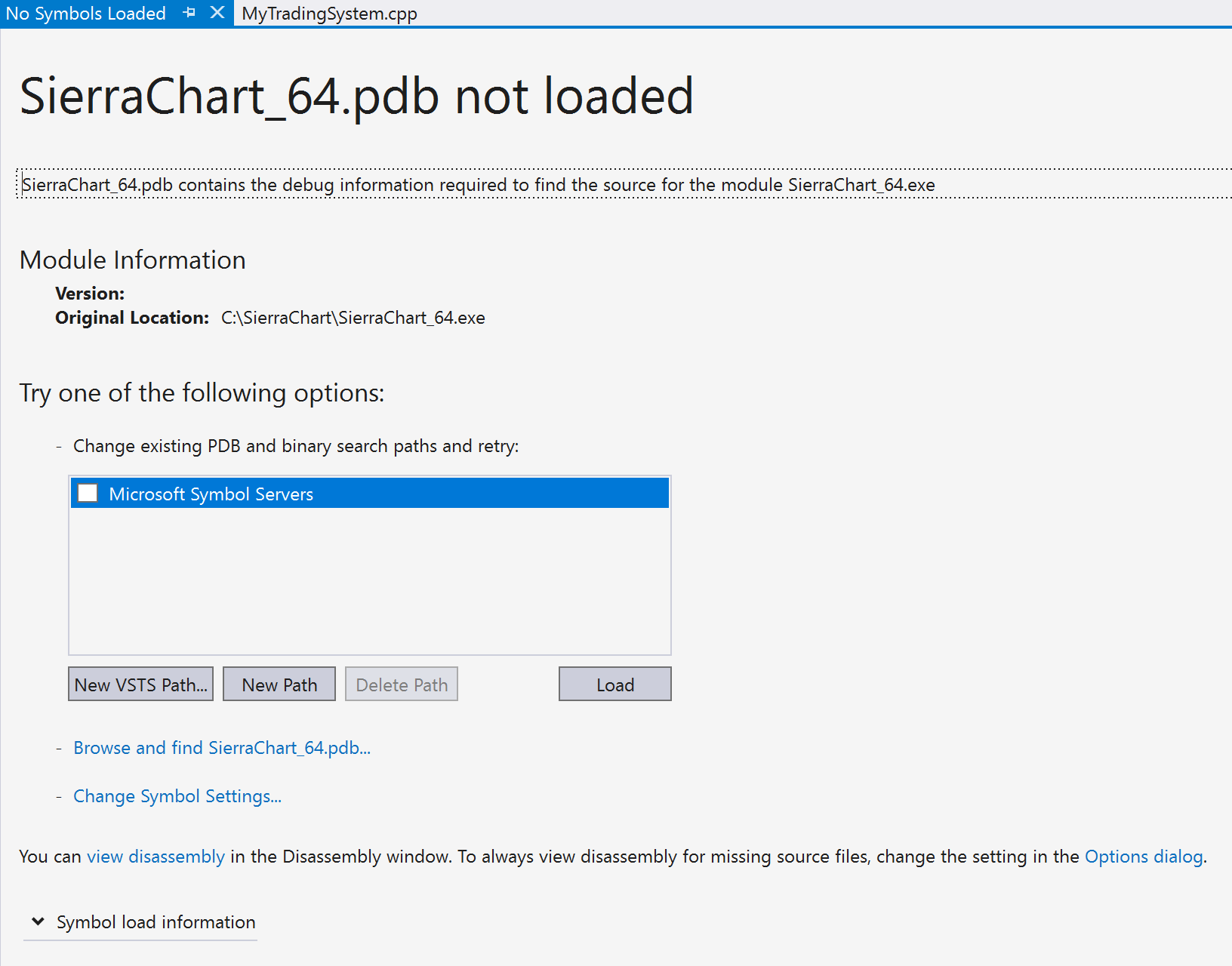

While I am debugging with Visual Studio, it gives the following error message.
SierraChart_64.pdb contains the debug information required to find the source for the module SierraChart_64.exe
Does anyone ever have the same problem before? Thanks!

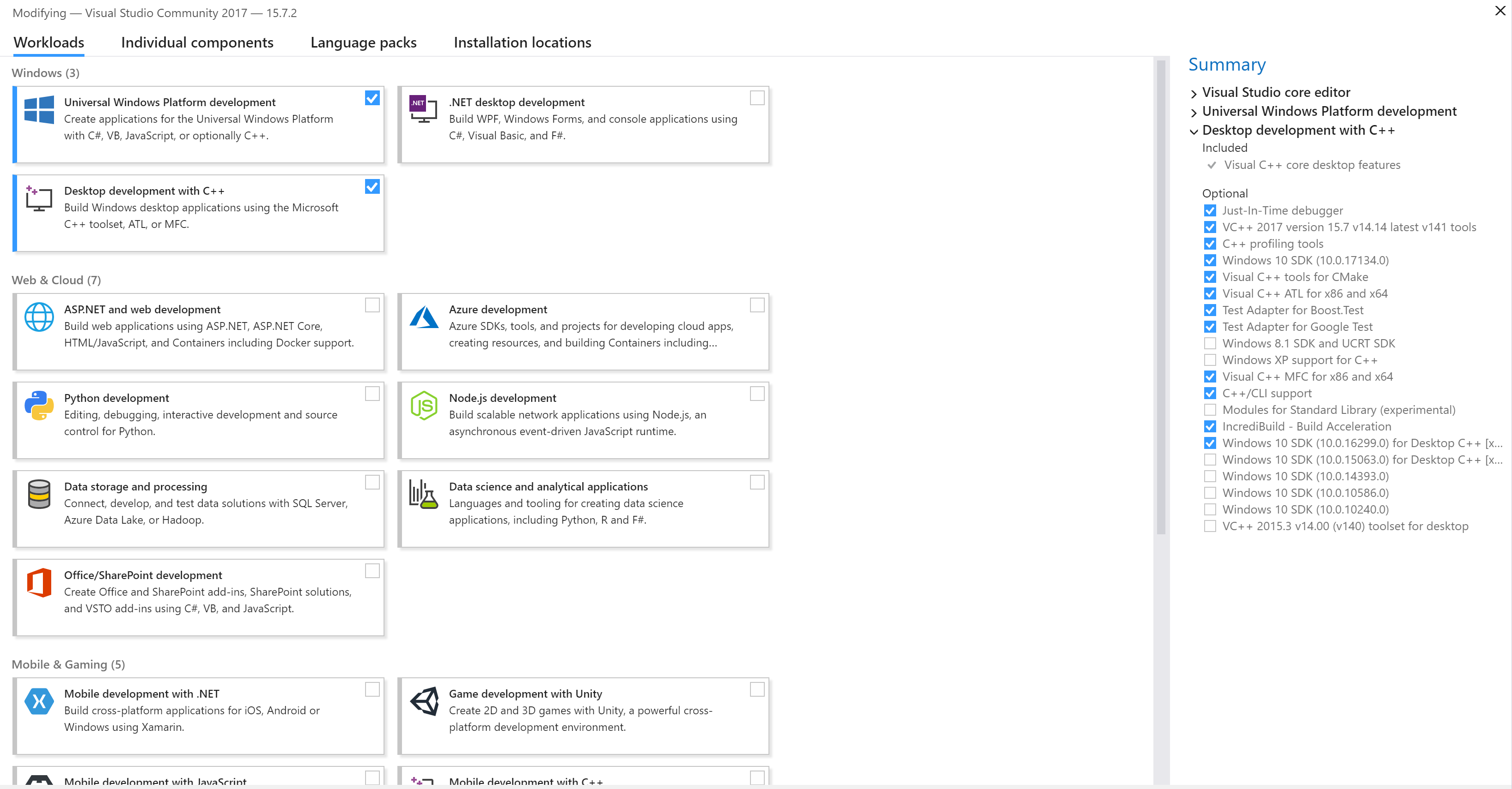

[2018-05-26 07:19:26]
Andy Sureway - Posts: 93
Unfortunately, I still don't have a success.
Attached please find the "error" screen from VS, and the components I have installed for VS.
My next trial is to add the .net environment component, to see whether it will solve the issue.

[2018-05-26 13:30:03]
Nope, adding more VS components does not help at all. The same issue pops out.
[2020-07-25 03:51:55]
ondafringe - Posts: 337
Two years later... did this ever get resolved?
I ask because I just had the very same thing happen to me on my first debug session:
After first pass through of code, I get that same message and same screen as shown in his first attachment:
"SierraChart_64.pdb not loaded"
And that stops debug in its tracks; can't get around it.
Can anyone shed light on this?
I was aware of the installation sequence issues a lot of people were having, so made certain I followed the correct install order. However, I did remember I had a trial version of VS Pro 2019 from a year ago that was still installed. So just to be certain, I uninstalled that trial version, along with VS Community, along with anything else related to VS, along with anything that had C++ next to it. Once I removed all that, I restarted my PC and went through the install process again in the correct order.
And I still got that same error message: "SierraChart_64.pdb not loaded"
Things weren't making any sense. Turns out, that message only appeared whenever I had a break-point set, then Stepped through to the end of the code, and then, while my cursor was positioned just to the right of the very last brace at the bottom of the code, I clicked Step through or Step over to start the code recycle again. That's when I got the error message.
So the solution was this: when stepping through/over code and you get to the bottom of the app, don't try to Step back up to start the code cycle again, press F5, instead.
At least that works, so far. Keeping my fingers crossed!
Thanks...

[2020-07-26 10:47:48]
ForgivingComputers.com - Posts: 1251
That is normal behavior when debugging. While your study is compiled for debugging, SierraChart_64.exe is not, so you can't single step out of your study back into the main application. Continue is required.

@Thomas: Yeah, but if you Step all the way down to the bottom of your code, and then try to Step out of your code entirely, you will probably get the same error message screen I did.
[2020-07-26 19:21:53]
Tomas.R - Posts: 9
@ondafringe Ah, you are right.
However, it's expected, right? Stepping out of the study method, which we have source file for, we instruct debugger to return back somewhere inside Sierra Chart code base itself and it's not possible since we do have neither Sierra Chart's source files nor debug symbols file available to use and I doubt SC team'd provide that resources to us ;-).
T.
Date Time Of Last Edit: 2020-07-26 19:26:07
[2020-07-26 20:00:33]
Exactly.
