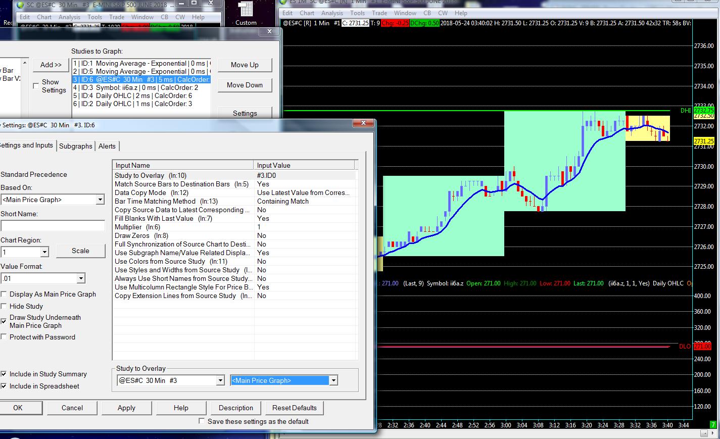

Hello, attached is screen shot of what I have so far....HOWEVER, two items of importance (1) H/L/C MUST BE THE "PREVIOUS" 30 min bar...like I said...at 10:10am, the Horizontal "HI" would be High between 9:30a & 10:00a. So, it's NOT exactly an overlay based on "same" time period (2) I DO LIKE the "fill" concept as screen shot shows....but ONCE AGAIN...needs to be based on the "PREVIOUS" 30 min bar, NOT the CURRENT 30 min bar.... Maybe a "different" study to be used?

Old thread, but thought I would post here since I stumbled on the conversation recently. Here's how I do it. Seems like what you're asking for. Attached is a Chartbook with a 1 minute chart and a 30 minute chart. The one minute chart has an overlay from the 30 minute chart's data for High and Low. Note the study formulas on the 30 minute chart. You can also do similar with the Value Area High / Low study for prior bar data as an overlay. Also note that on the 1 minute chart, the studies need to have the bar time matching criterion set to "contains match" in the study settings, otherwise, the overlay is offset by an incorrect amount.

Looks like the screen capture failed. Here's another attempt. Happy trading.
