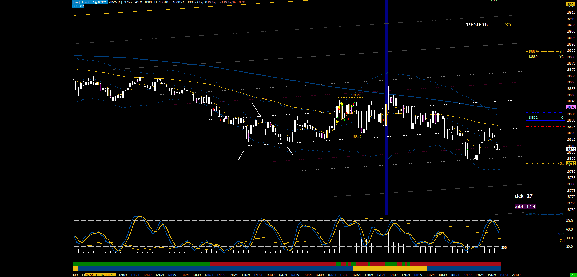

I have the subgraphs of a study with a setting of displaying it at the last bar to edge,
Is it possible to displace the subgraph not to start at the last bar edge(yellow vertical line)
but instead displaced at where red vertical line is? (so there is blank space left between the yellow and red line)
imagelast bar to edge displacement.JPG / V - Attached On 2018-05-23 13:16:18 UTC - Size: 61.65 KB - 602 views

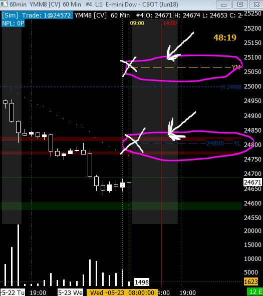

[2018-06-03 11:30:45]
User924725 - Posts: 26
hello,
weird becasuse i am sure that before some time you supported this ,
see the chart and you will figure out why
my chart was like this and after some updtade you made it stopped working ,
from that time the lines you see at the right edge of the chart are like my picture in the first post,
imagedisplacement line at last bar edge.png / V - Attached On 2018-06-03 11:26:29 UTC - Size: 56.98 KB - 529 views

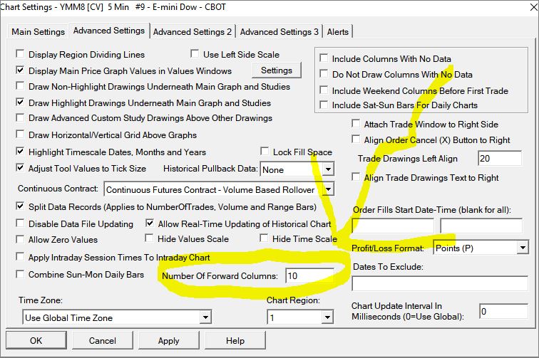

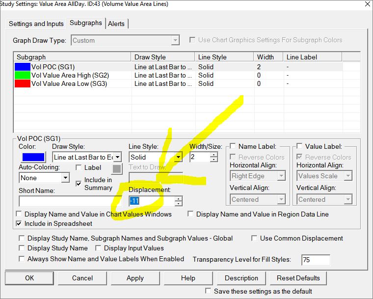

then this is a mystery because the image in the previous post is Sierra charts!
i remember that i have used the displacement feature from study subgraph settings (see picture ''displacement'') with a minus setting below -10 (like -11 or -15 etc )
and number of forwarded columns from chart settings to 10 (see picture ''forward columns'')
but with same settings now i cant reproduce the same result
imagedisplacement.JPG / V - Attached On 2018-06-04 19:41:01 UTC - Size: 109.01 KB - 526 views
imageforward columns.JPG / V - Attached On 2018-06-04 19:41:52 UTC - Size: 106.58 KB - 551 views
