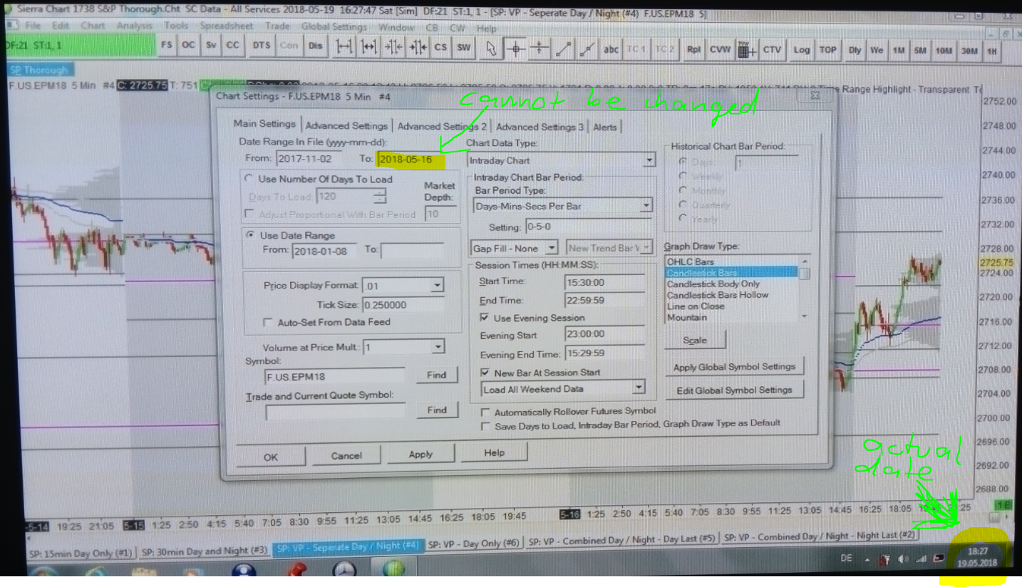

I am currently testing your platform and am very impressed. However, I'm experiencing an error that freezes all charts from the 16th (being the last day to look at) till today.
I read through a lot of your support tips, checked and can asure the following:
•Symbol settings are updated
•I scrolled to the end of the chart
•"Disable Data File Updating" is disabled
•I made sure that no dates are excluded
•Historical Data Download is always successful
•The connection to the data feed is successfully established
•Although I had storage space issues, no "Windows Error Code 8" is listed in the Message Log
However, I noticed that the box in Chart Settings -> Main Settings -> "Date Range in File" -> "to" is filled with 16.05.2018 and can NOT be changed (see attached file).
How do I solve this issue?
PS: It is especially frustrating since my trial will expire on the 21st, which is why I wanted to ask if it was possible to extend my trial to the indicated 30 days (I read that this was possible)
Thanks in advance and have a great weekend
imageSIERRA ERROR.PNG / V - Attached On 2018-05-19 19:29:21 UTC - Size: 2.28 MB - 476 views

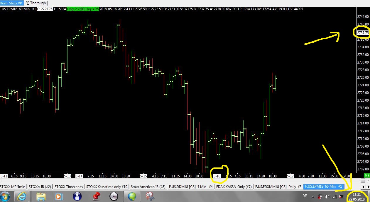

However, I'm not sure whether the issue you mentioned really is the cause of my problem. First of all, I don't get any error stating "invalid Symbol" or "Symbol unknown", secondly, I can see the current Price tag moving realtime on the right hand side (however no Chart available as it stopped moving on the 16th, and thirdly, the symbol was working perfectly fine prior to the 16th (I also checked whether the Symbol had a rollover, but that was not the case)

[here you quoted me:]", secondly, I can see the current Price tag moving realtime on the right hand side (however no Chart available as it stopped moving on the 16th,"
This does not make sense. How can the chart be updating in real time but yet stopping at the same time?
Let me assure you, I am just as confused as you and provided proof in the form of two attached screenshots.
Secondly you are very right. I use the CQG Data service through AMP, who also gave me an introduction to how to set it up. However, it appears that I have set it up correctly, as all other symbols move realtime, as they are supposed to...?

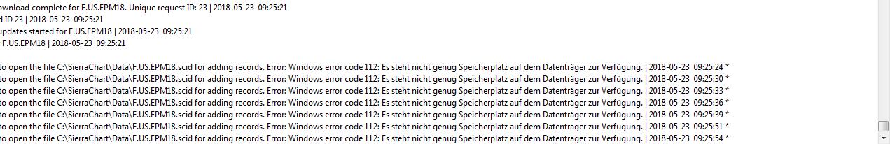

However, when I checked, I started playing with the "Intraday Data Storage Time Unit"-Setting and set it to "1Tick".
Subsequently I recieved an Error 112 in the Message Log (see attached file) which states in German that I lack free storage space. Could that be the root of the issue? (If so, is there a way to save the respective data on an external hard drive?)
Yet, something is still confusing to me: How come the F.US.EPM18 does not show price movement in candlestick devolopment (however does so in the price tag on the right of the Chart), while the F.US.DDM18 is moving perfectly fine, although being connected to the same Data Feed and using the same computer for storage?
imageSIERRA ERROR.jpg / V - Attached On 2018-05-23 10:08:40 UTC - Size: 71.32 KB - 446 views
[2018-05-23 17:42:42]
Yes, error message 112 does mean "There is not enough space on the disk. ". That definitively is the problem.
