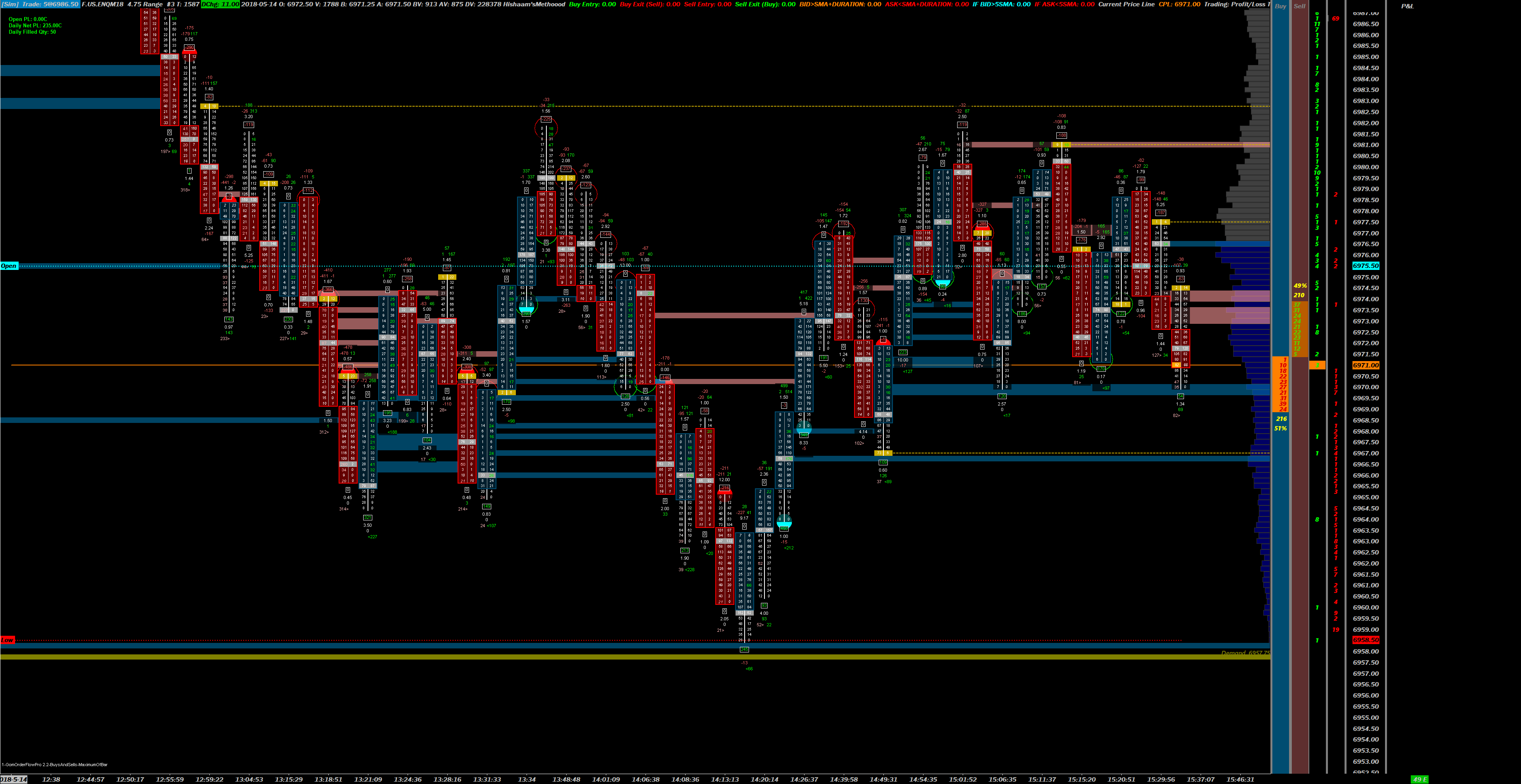

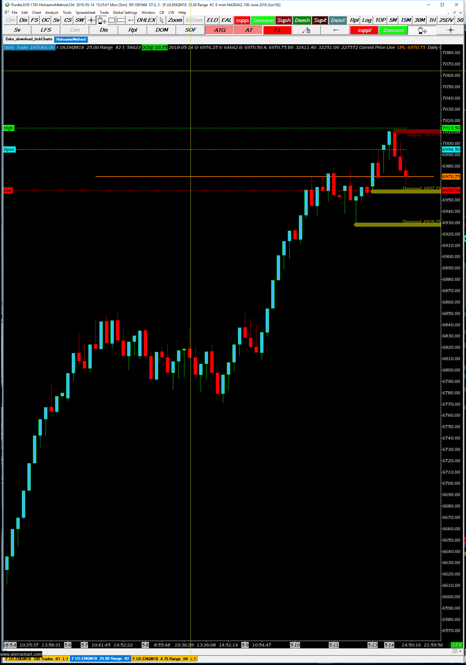

now the following snapshot shows how the tool behaves between 2 charts with the same symbol (one is 25.00range on the right & 4.75 range to the left)
http://www.sierrachart.com/image.php?Image=1526326500933.png
://www.screencast.com/t/7FJGDZesw
