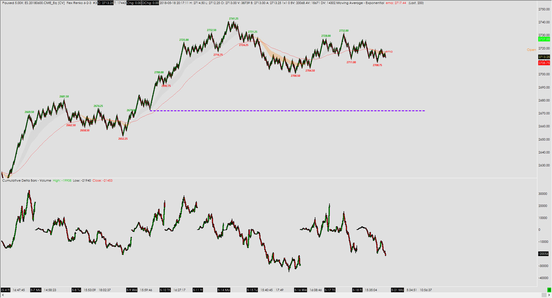

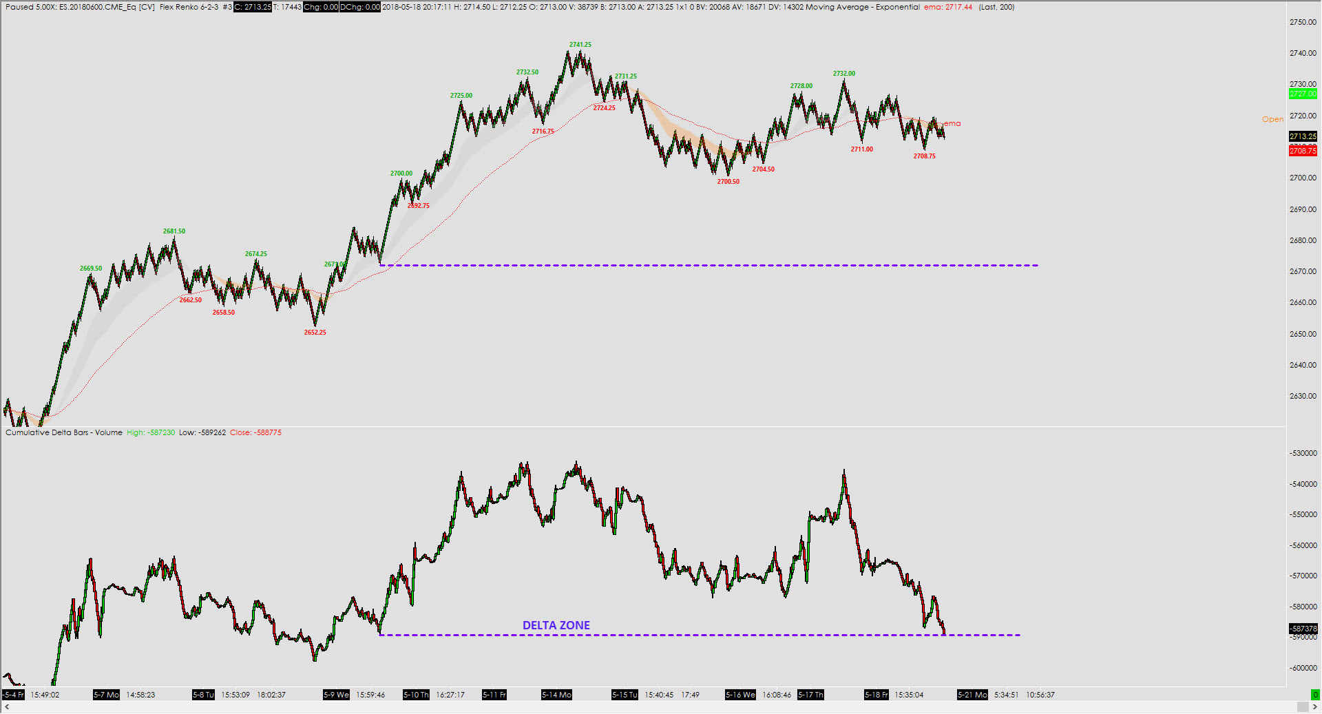

Every time I open Sierra, the trend lines I drew in the area of the Cumulative Delta find them scattered
How can I solve this problem?

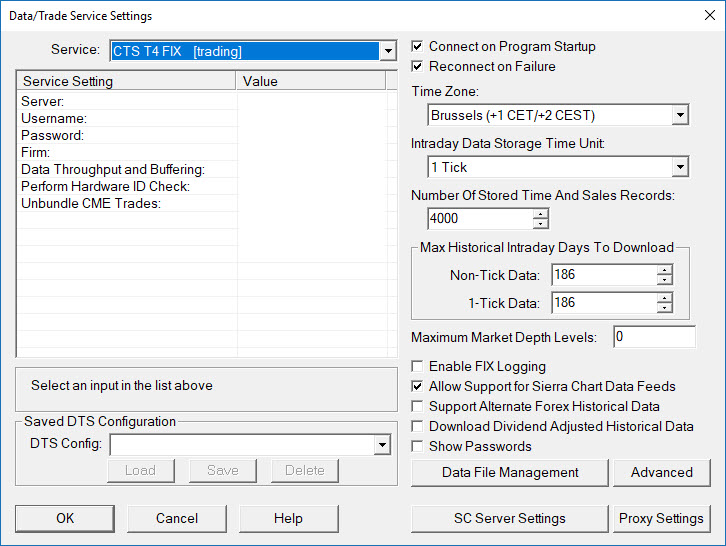

My sierra is configurated Tick ​​by Tick Data, but probably did not understand me.
My question was: Every time I open Sierra, the trend lines I drew in the area of the Cumulative Delta find them scattered

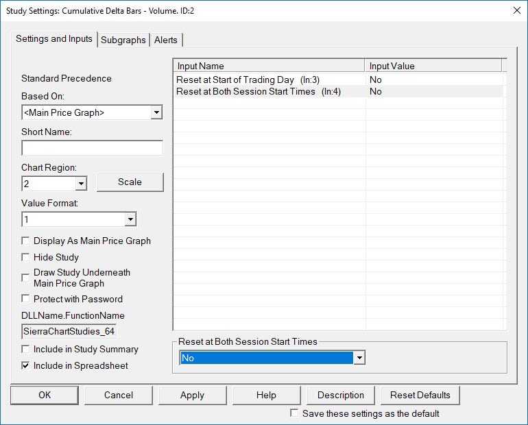

User00111 - Posts: 111
Attaced Setup

[2018-05-17 19:14:24]
This is what we referred you to:
https://www.sierrachart.com//index.php?page=doc/StudiesReference.php&ID=292&Name=Cumulative_Delta_Bars_-_Volume#CumulativeDeltaBarsDrawingTools (Using Drawing Tools on Cumulative Delta Bars)
Make sure you read that particular section.

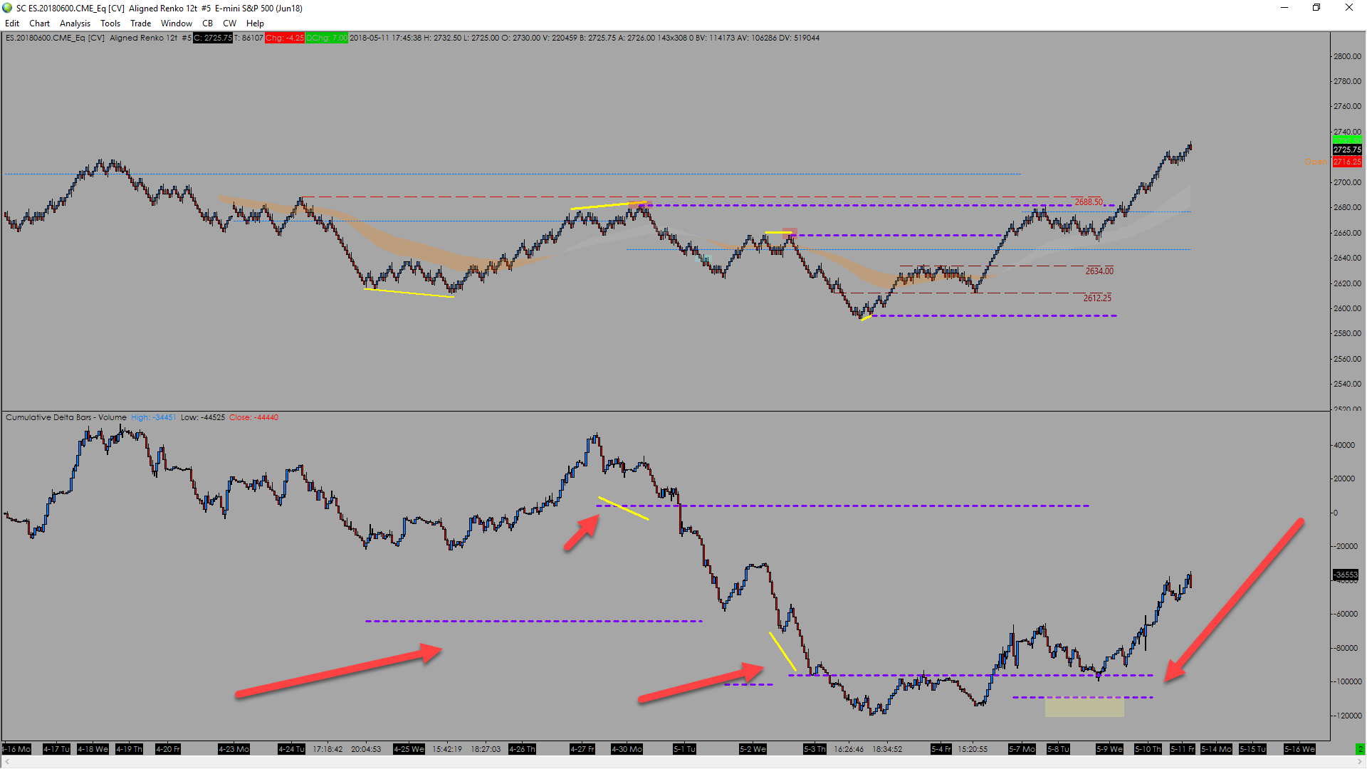

[2018-05-19 17:26:51]
To display the delta cumulative correctly in order to view the Delta Zones as per attachment, the reset fields must be set to NO.
It is possible to solve this problem in order to avoid that every time I open the trend lines identifying the Delta Zones on the cumulative delta are all moved as per previous attachments.

[2018-05-21 17:17:09]
You need to set a fixed starting date. In Chart >> Chart Settings, select Use Date Range, set the From date to a specific date, and leave the To date at 0.
