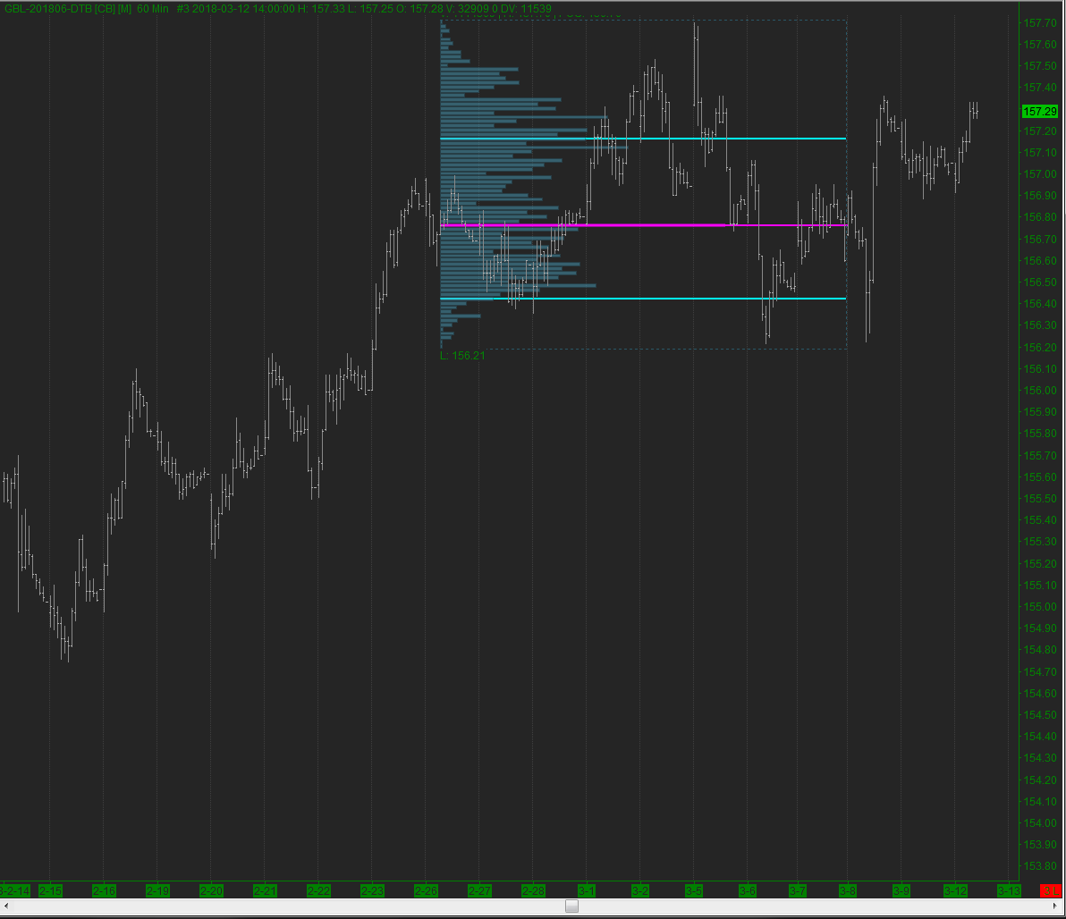

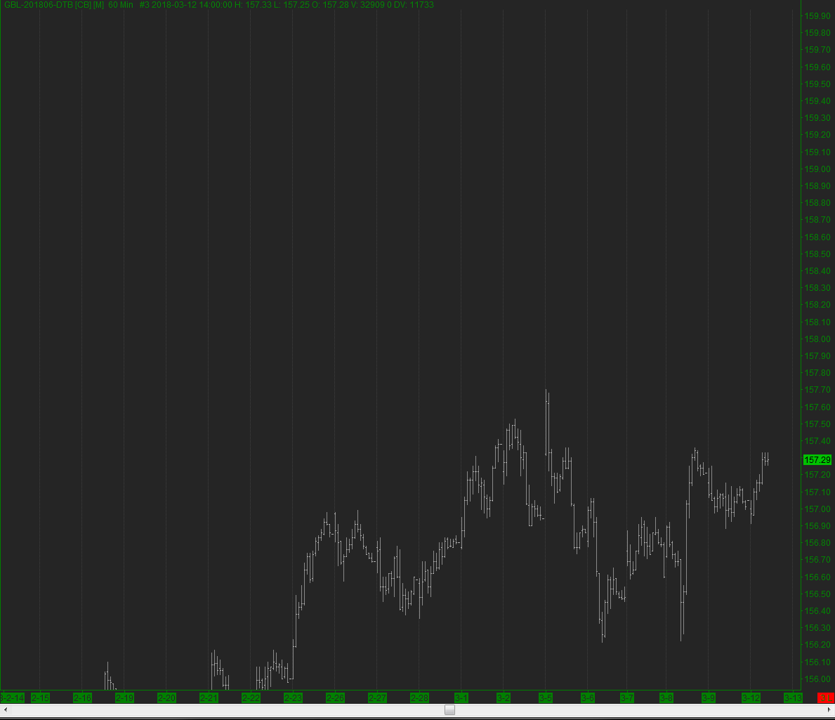

I use the manually drawn volume profiles a lot. My chart scale is set to constant range "manual mode". When you delete a volume profile, the chart jumps vertically up or down every time. Often with the bars completely off the screen. Is it possible that you can fix this so it doesn't move at all after delete? It makes doing market study and review across a variety of instruments so much more tedious than it needs to be.

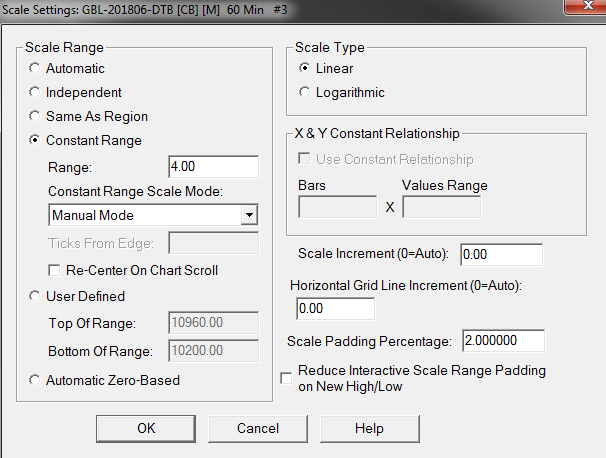

Go to the Scale Settings for the Volume by Price study on the chart and let us know what the Scale Range is set to. Refer to:
http://www.sierrachart.com/index.php?page=doc/Scaling.html#ScaleWindowStudy
[2018-05-08 06:35:36]
User19165 - Posts: 346
Yes it does not make sense, that is why I posted the problem.
I think its related to when you scroll into historical data. It will always move vertically some after deleting the first VP. Subsequent VPs do not jump the chart. Sometimes the jump is significant.
Please fix, this has been a problem ever since I became a user over a year and a half ago.

Okay, we understand. It is because there is a scale reset occurring.
We will see what we can do with this.
