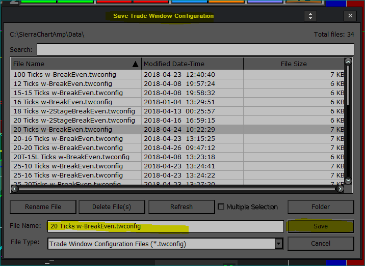

Xfanman1 - Posts: 320
You need to Save Configuration in the trade window menu after you rename or create your new ATM strategy. If you forget this step it won't save your changes.
Scott
imageSaveConfig.PNG / V - Attached On 2018-05-01 18:15:03 UTC - Size: 37.46 KB - 456 views
What I need is shown in the Dom that Sierra charts has. It is the dropdown arrow at the top left of the SC DOM. How do I add or remove a name and its associated targets and stops from the window that drops down when i click on the arrow that points down?
I think we're talking about the same thing. Look at the link that SC Support posted above. The Trade Window menu is where you'll find the Save Configuration menu item that I posted. All the trade configurations are setup in the Trade Window tabs then named and saved via the Save Configuration menu item I posted above. After you name and save your new configuration, it will be available in the drop down menu you first referenced.
If that's not what you're trying to do then I AM confused ;^)
Scott

[2018-05-01 22:39:31]
User432504 - Posts: 73
Yep. I was missing the step where I needed to click on the M or Menu tab and then select save config. Thanks to everyone for their help. Got it now
