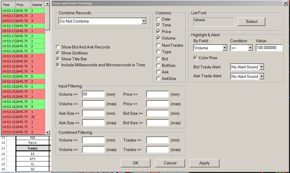

I'm using a Time and sales window with a filtering in the volume (greater than). It was working yesterday in version 1733 (I believe it was the version I had), but this morning, the window shows every trade regardless of the volume.

See attached printscreen that shows the Time and Sales Window and its Times and Sales Settings window.

Are you sure that is the Settings window for that particular Time and Sales window?

lpfin123 - Posts: 59
Yes I am. And this is for all my chartbooks (which are almost all the same but for different symbol).
Do you suggest to try the pre-release? Go from 1738 to 1739?
I've just tried to change the number inside the box, and it seems like there was a "reset". Seems like it was considering an empty box until I changed the number.
This seems to be solved on my side (maybe not on your!). I'll comment again tomorrow if this is not the case (Volume are small and slow at this time of the day).

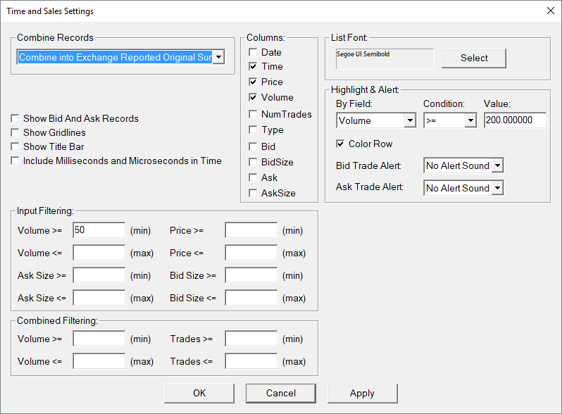

I am having very similar issues.
I have combined records on and filtering set at a numeric value but the time and sales window is showing trades much smaller than the numeric value.
I am on 1739, the Sierra real time data feed and have attached a screenshot of the settings
