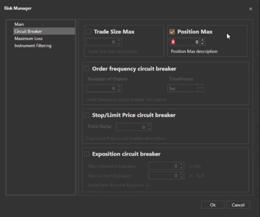

I would like to transition from my existing platform AlphaTrader to Sierra but I will be missing features which are key in managing my trades and avoid mistakes (manual trading on numerous instruments of variable sizes at the same time)
max position per instrument: most important
if said qty is reached, prevent to pass further trades on that instrument. if opened qty is below the limit and new upcoming order would override the limit, then also prevent the upcoming order to happen
max trade size : set a max qty per order, in order to avoid fat fingers and manipulation errors. if trade qty entered is too high, correct it to max qty (or avoid it and ask to reenter apropriatly)
hopefully, those protections can make their way into Sierra ? thx

Here are a few remarks:
1) about the order quantity limit, maybe there should be an exception when the Flatten button is used.
Right now, if this limit (alone) is set at 2, then you buy a quantity of +2 three times, it won’t allow you to flatten since it would equal a -6 order. This is understandable but maybe not practical since one could consider the need to flatten as an emergency measure.
2) same remark for “Trade position limit”. Once the limit is exceeded, it becomes impossible to flatten the position with the Flatten button ...which can be quite stressful
Actually, about “Trade position limit”, I am sorry to report that it has a random behavior. For instance, if I set the limit at 3, I can manage to buy +1 six times before it locks up. I tried other combinations, and often I can exceed the limit.
Last, I am not sure what you tried to achieve by “Trade position limit”, is that the maximum count of trades on the same side ? if so, such protection has a limited use since by modifying quantities there are so many combinations possible to trick it
I believe a “max position quantity“, which I requested in my initial message, would be more useful, simple for you and secured (more relevant tighter protection about global exposure)
exemple : limit = 4
+1 +1 +2 (3 consecutive orders) would be accepted
but +1 +1 +3 ....the last +3 order would be rejected because otherwise it would exceed a quantity of 4 from the same side
+2 +1 +4 ...the last +4 would be rejected as well
Thanks for your time
