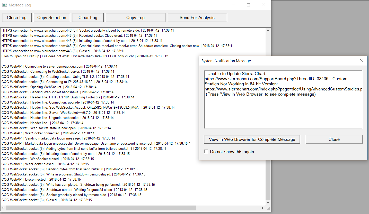

2 days ago I tried starting the platform, however a window with an error message occured.
I was away for a day, but the problem remained once I tried to log in this morning.
I will attach a screenshot of what the wondow displays.
How do I get the platform to work again? What's interesting is that I haven't changed anything prior to its error.
Regards.
imageSIERRA Problemmeldung.PNG / V - Attached On 2018-04-12 15:52:20 UTC - Size: 104.27 KB - 475 views

You are getting this error:
CQG WebAPI | Market data logon unsuccessful. Server message: Username or password is incorrect
Refer to number 2 in this section here about this.

Ok thank you, the settings are configured in the way they are supposed to be. I'll contact CQG and see what the problem appears to be.
What about the smaller error window, is that issue connected to the discussed problem?
Regards
[2018-04-13 18:03:53]
The System Notification window just contains some informational messages on topics you might need help with. They are not relevant to this.
