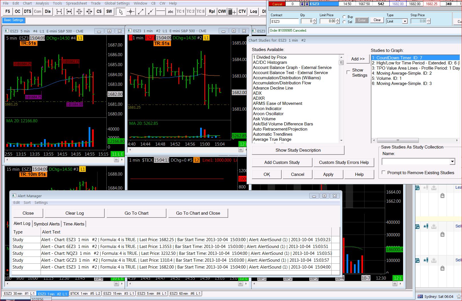

Any idea on this?
Attached is the screen shot of my alert log.
When I change symbols the alert fires and the log window pops up.
You can see that I changed symbols 5 times and got 5 alerts.
Also in view is the studies window of the chart in question.
imageAlert Manager.JPG / V - Attached On 2013-10-04 20:16:48 UTC - Size: 365.31 KB - 728 views
[2013-10-05 01:17:16]
Go to Chart #2. You can find this chart on the CW menu on the main window. Be sure to look at the chart numbers on the far right side of the list. Not on the left side.
Once you go to that chart select Chart >> Chart Settings. Go to the Advanced Settings tab. Remove the Simple Alert Condition formula.
