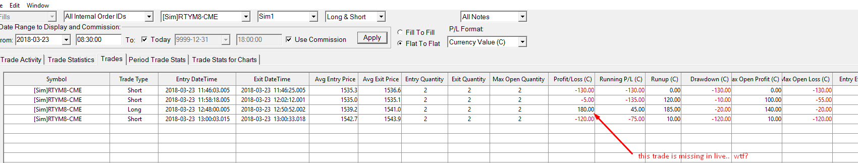

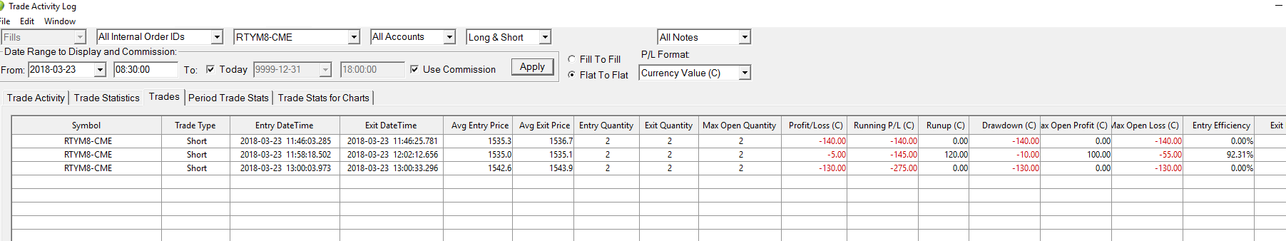

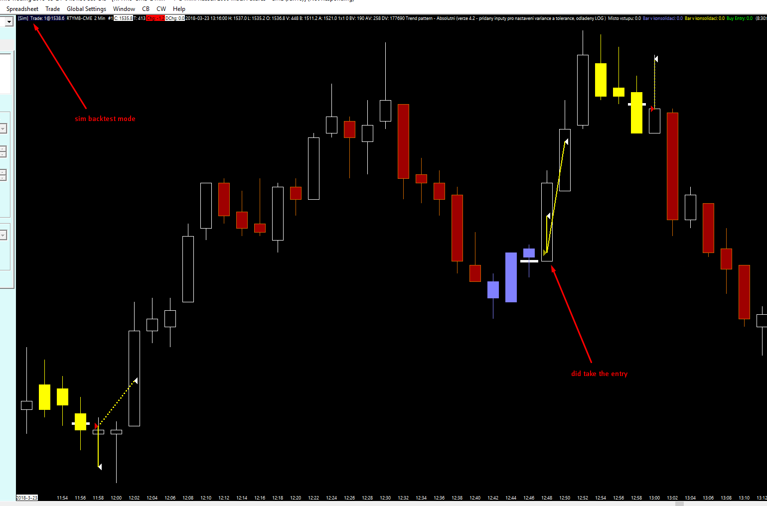

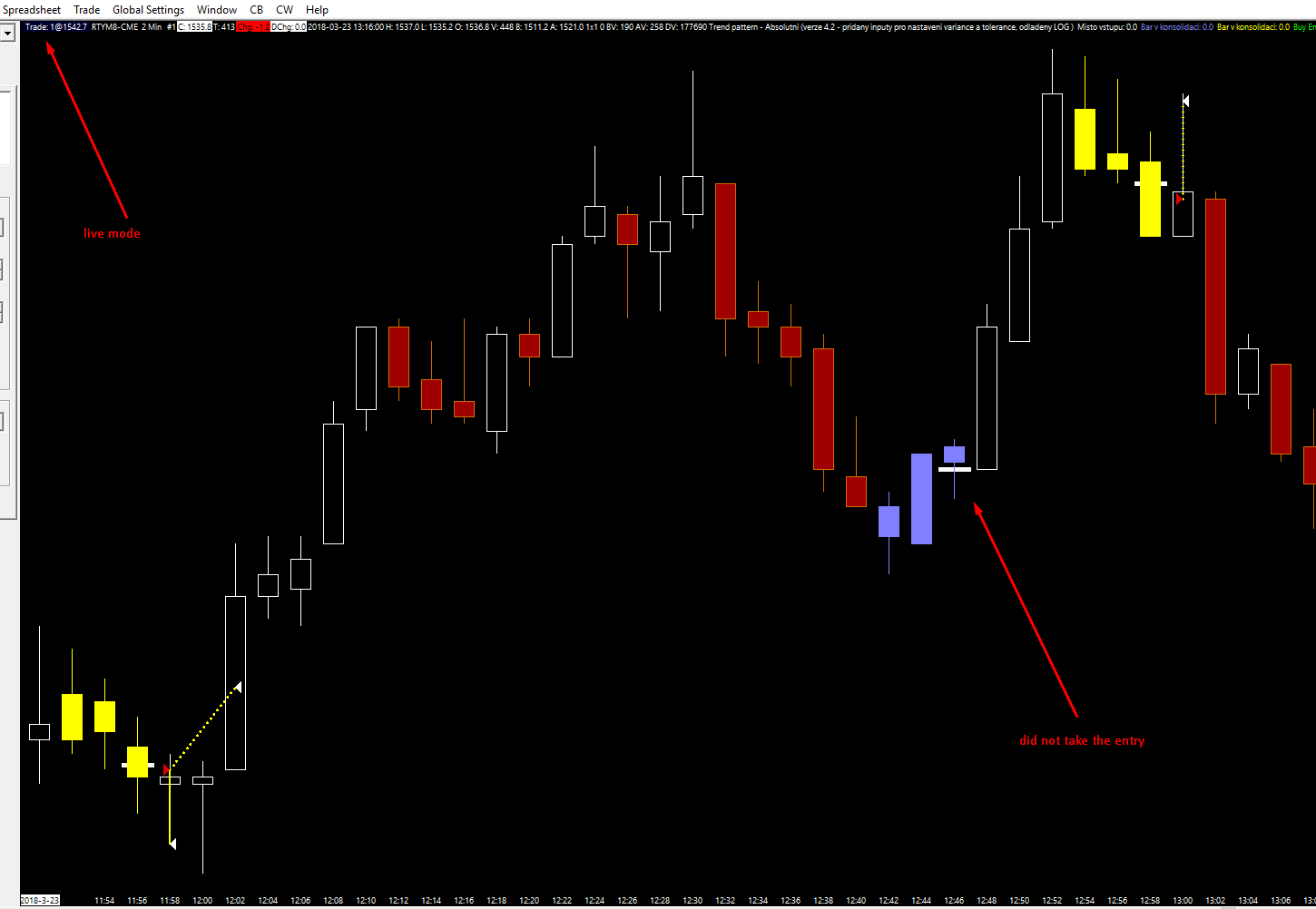

i wanted to ask, how it is possible that there are such significant differences between real-time live automatic trading based on ACSIL and sim bactest results of the same AOS?
for example on Friday, a simple script based on price action was set to do real-time trading (written in ACSIL) and it did not take a trade that it was supposed to take according to the condition written in the code.
i did a sim backtest of the same day with the same AOS and it did take the particular trade.
the question is - how it is possible that in backtest it takes a trade and in realtime live it does not - when it is completely the same code??
if it works like this, then all the coding and bactesting of an aos strategy is a complete waste of time.
i understand that there might be some slippage or that a simulation environment is slightly difeerent ets.. something like this, but i dont understand why it does not take a trade when the condition is met.. and in sim beckest mod it takes it with no problem
can you explain please?

imagelive mode.png / V - Attached On 2018-03-24 10:01:55 UTC - Size: 39.57 KB - 628 views
imagesim mode.png / V - Attached On 2018-03-24 10:01:59 UTC - Size: 53.93 KB - 603 views
imagelive mode result.png / V - Attached On 2018-03-24 10:02:03 UTC - Size: 33.91 KB - 539 views
imagesim mode result.png / V - Attached On 2018-03-24 10:02:05 UTC - Size: 35.99 KB - 642 views

well, ok i understand digging into someones AOS is beyond your scope of support on the other hand i am not asking anything so strange or super detailed to be explained.
my question is simple and very general: why an acsil DLL behaves differently in realtime live and on sim backtest mode?
when i have the same code, the same setting, in the same market with same timeframe, i expect it to do the same thing on live as well as on sim mode. (except some slight differences in fills due to slippage etc.)
these two pics show the difference: on sim becktest it takes a trade on realtime it does not (without sending anything to service log) - it just skips it

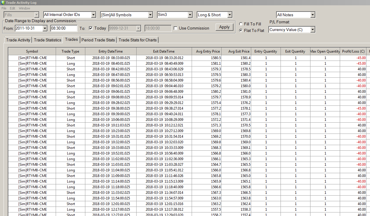

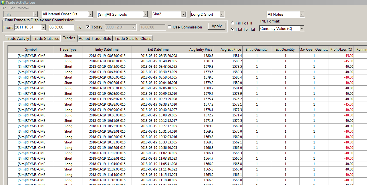

i used trading example with hardcoded attached orders (scsf_TradingExampleWithAttachedOrdersDirectlyDefined), but the same happens with all other studies.
add this study to a clean chart on sim1, run a bectest, then switch to sim2, run the same bectest, switch to sim3 run the same becktest... in all cases u will see the timestamp entry differs (couple of dozens miliseconds - not a big deal but still, it is there. to me as a non-pro software designer this is a mystery why it can happen).
on different systems it differs for a different ammount of time. sometimes 10 ms, sometimes 20, sometimes 30...
when i restart siera and run the test "for the first time", the timestamp is the same as it was on the previous sim1. so it seems like if siera holded some latency somewhere inside after each test that influence other tests. but i have really no clue.
not a big inconsistence, that is true.
but when i take into account that this is really a very very simple trading example which u designed, i am asking to myself what kind of inconsistency i should expect from a trading system with several loops using tick data, market depth, itterating through stl containers and other much more complex stuff (á ala hft algo), which will be designed by me, an amateur..
Date Time Of Last Edit: 2018-03-28 19:31:58

imagesim2.png / V - Attached On 2018-03-28 13:45:00 UTC - Size: 82.16 KB - 553 views
imagesim3.png / V - Attached On 2018-03-28 13:45:11 UTC - Size: 92.71 KB - 611 views

In post 10, you are apparently only pointing out inconsistency with timestamps.
This is meaningless. And it has to do with the fact that there is other data in the Trade Activity Log, which is accumulating as you are changing the trade account, and timestamps need to be unique so this is why the milliseconds are incremented to avoid conflicts.
There are no profit/loss discrepancies in our testing. None at all. So after this entire thread, what have you proven here? We have not identified any fault here in Sierra Chart. If there is, will take care of it.
Therefore you can understand, why we are very assertive to users at times. When we know there is not a problem we are going to be very clear about that. And there is no problem. We simply cannot identify any issue.
Obviously the original issue is an inconsistency with the submitted orders, and Profit/Loss. Millisecond timestamps differences are meaningless.
So once again as we have said time and time again check your system if it is giving different results. Our example trading systems are not. We do not know why you are having an inconsistency with yours assuming you are with back tests.
Now while looking into this, we did make a small performance improvement in 1726, and made absolutely certain there is 0.000000% potential for any variation.
