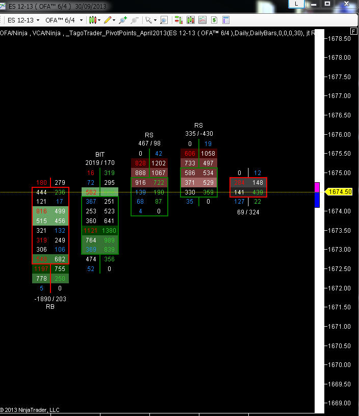

But there is no open code for coloring the bid/ask letters (not background). For example – print light blue all bids that have lower value than 5 (not background but the color of the numbers).
If you have coded that – would you be willing to share part of this code so I get some inspiration how this is done?

imdtrader - Posts: 26
The coloring method is too global for me. I wanted to try to code something in the style of ofa footprints which is done for Ninjatrader here https://www.bigmiketrading.com/elite-circle/2100-volume-ladder-highlight-addition-109.html#post359541
So I guess this is not yet possible with SierraChart.
imageofa new2.jpg / V - Attached On 2013-10-02 08:18:04 UTC - Size: 78.44 KB - 953 views
