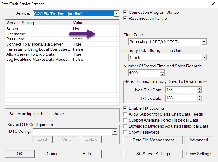

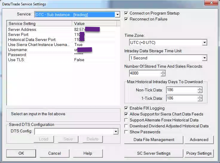

I try to explain better.
I use two PCs configured on a different network with different IP.
On the 1Pc I use CQG trough Dorman Trading...(Attaced Picture A)
On the 2Pc on server address I put IP where Sierra is installed with CQG (Attaced Picture B)
What should I configure to make the 2PC work?
In 2PC I need to use the same Username and Password as 1Pc ?

[2018-03-16 18:59:17]
One thing you also need to do is you need to support port forwarding on the first PC through your NAT device. You need to support this for both of the ports that have been specified in the DTC sub instance.
Yes but this will happen automatically based on the settings we see. So nothing you need to do.

[2018-03-16 19:12:19]
User00111 - Posts: 111
I am sorry but what is NAT device ?
[2018-03-17 00:35:51]
This would be for example a router. And in addition, the firewall on the computer running Sierra Chart connected to CQG, also has to allow connection on those ports.
