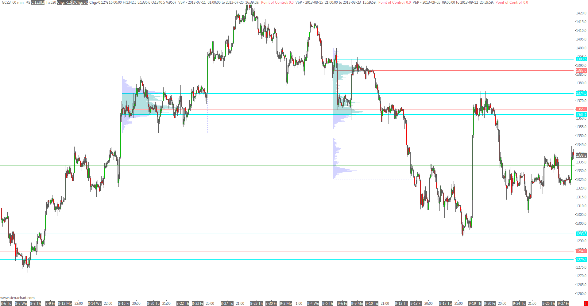

http://www.sierrachart.com/image.php?l=1380691857798.png
[2013-10-02 06:02:31]
You got three different Volume By Price studies on the chart. The extend Until Future Intersection option does not work among separate instances of the study.

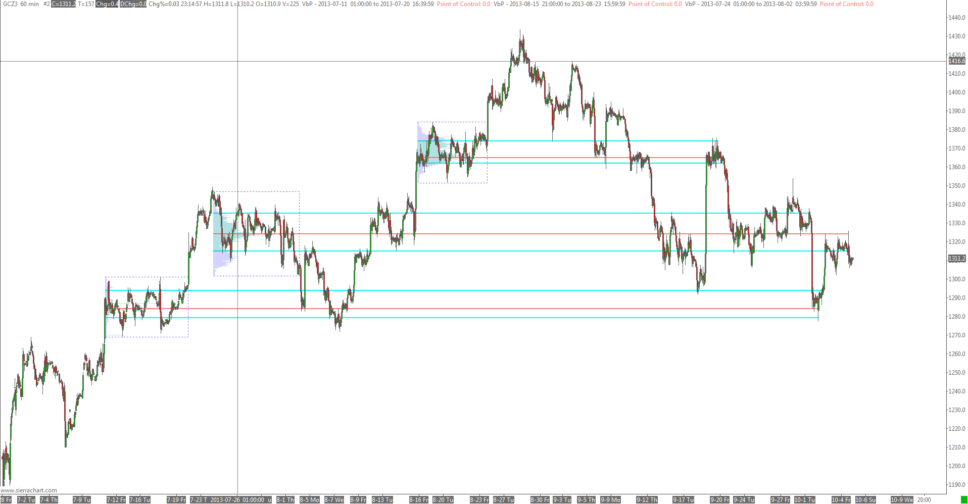

looking at the chart now: http://www.sierrachart.com/image.php?l=1381086540961.png
"when they intersect future prices" - well they stop after a couple of intersections with future prices. what eg is reason for stop of lines for the lowest profile?
The thing is that intersection is not intersection. when prices only hit slightly the area it is still valid. once traded to other side for eg 20 USD (in case of gold) - that would invalidate.
but anyway, pls dont think I am ungrateful, I very much appreciate you did change that. but in case you once find the time (whenever) it would be great to have an "until date/time" option. :-).
I can also work around, no problem. when the VA is invalid I just change settings to "not extend lines" for those studies.
