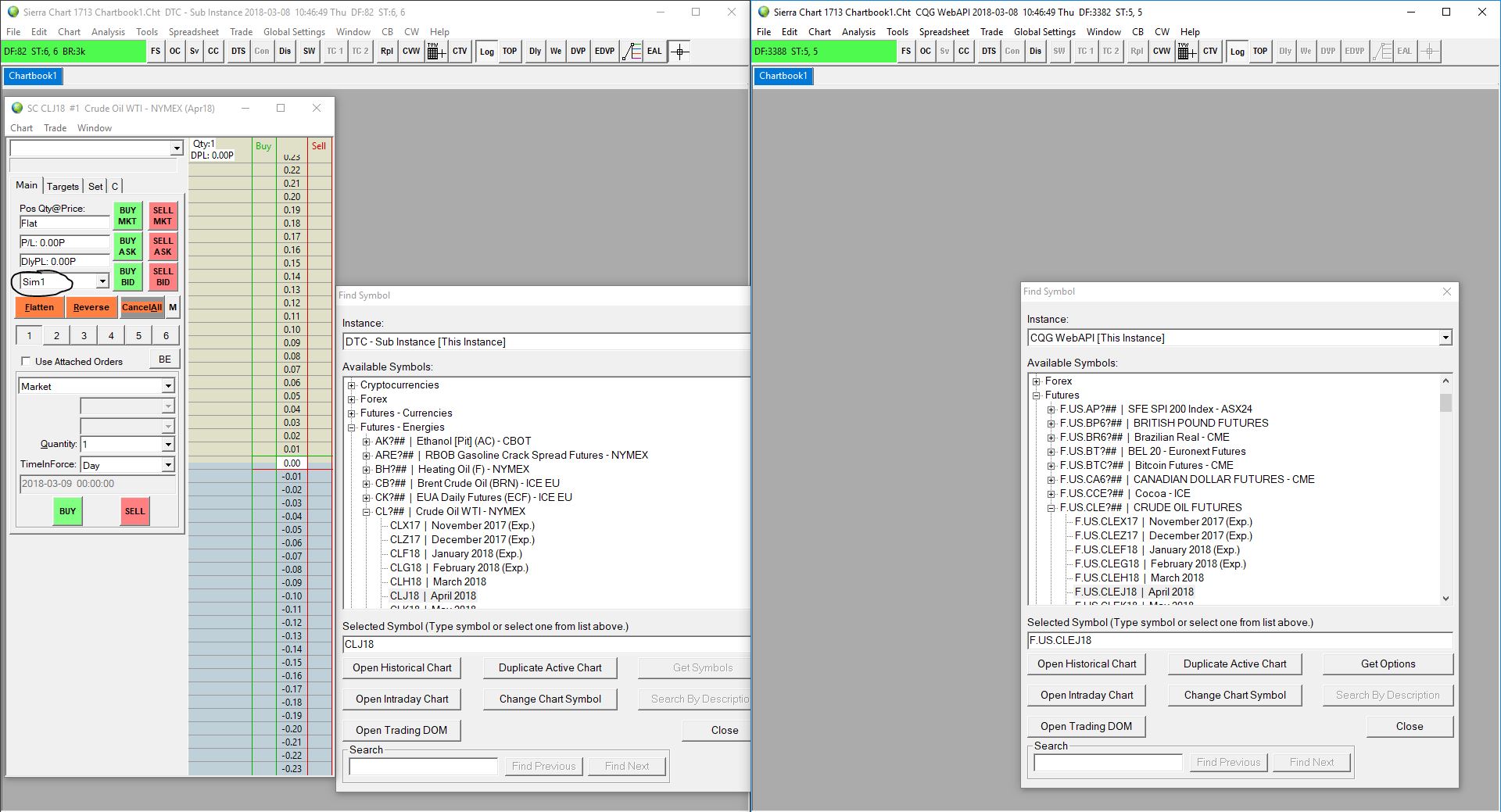

I have deleted my sub instance and all the data and started a new one using File >> New instance.
The screenshot attached shows "find symbol" in both my main instance (right side) and sub instance. The symbol for crude oil is "F.US.CLEJ18" in main instance but "CLJ18" for sub instance. So the new instance is not showing my actual data feed's symbols (CQG WebAPI) which is why market depth is not being shown.
There are no problems with main instance. Problem is only with sub instance which remains even after deleting all previous instances. There is no check mark by "Trade >> Trade Simulation Mode On" in both the instances. Also "Enable DTC protocol server" is disabled in sub instance. I am unable to figure this out.
imageSc.JPG / V - Attached On 2018-03-08 05:51:50 UTC - Size: 289.32 KB - 599 views

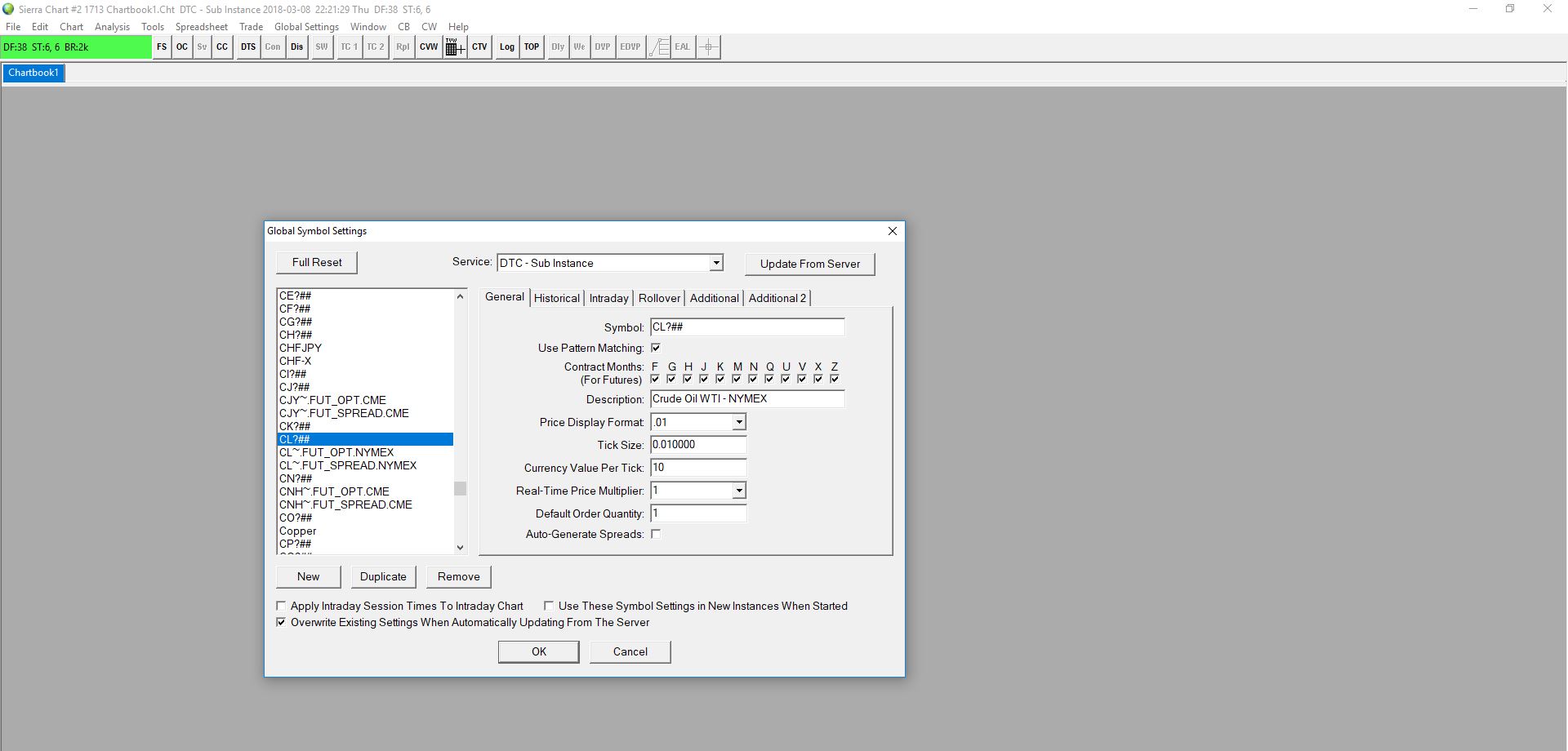

In the sub instance, while it is connected to the data feed perform a Full Reset of the Symbol Settings:
https://www.sierrachart.com/index.php?page=doc/GlobalSymbolSettings.php#FullResetSymbolSettingsSteps
In that Trade Account list box with the simulation account, that does make sense to see that account there. Just click the down arrow and select your CQG account. It will be listed there.

User336964 - Posts: 29
Have already done full reset earlier and again now. Even in those symbols list, crude oil is shown as "CL" instead of "F.US.CL". Also in that trade account list, only 'sim1" exists in down arrow. In the previous sub instance which I deleted now, I changed instance setting from DTC-subinstance" to "CQG-WebAPI" and that changed symbols list back to the default but even then, down arrow did not show my CQG account even though trade simulation mode was off. I did not change instance this time but nothing seems to work. Attached is symbols list after full reset now.
Date Time Of Last Edit: 2018-03-08 17:18:20
imageSC2.JPG / V - Attached On 2018-03-08 17:17:50 UTC - Size: 136.45 KB - 522 views
