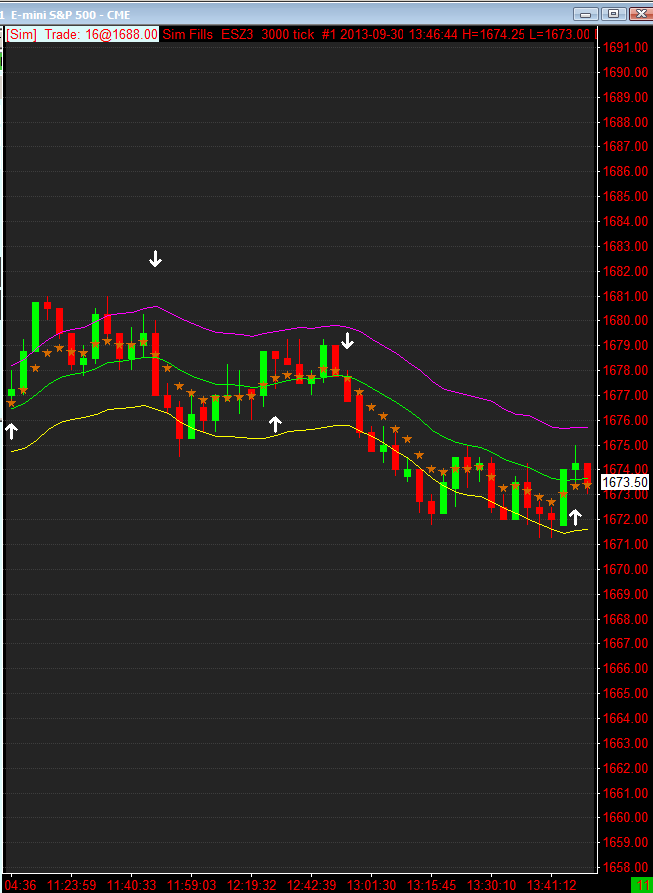

Do you know what formula I put in the Alerts dialogue box so an alarm is sounded each time one of these arrows displays? It is the MACD Crossover indicator that is standard in SC.

image123.png / V - Attached On 2013-09-30 19:52:26 UTC - Size: 37.77 KB - 1248 views

Try this:
OR(SG1>0,SG2>0)
[2013-10-01 02:52:57]
The formula given in post #2 is what you want to use.
