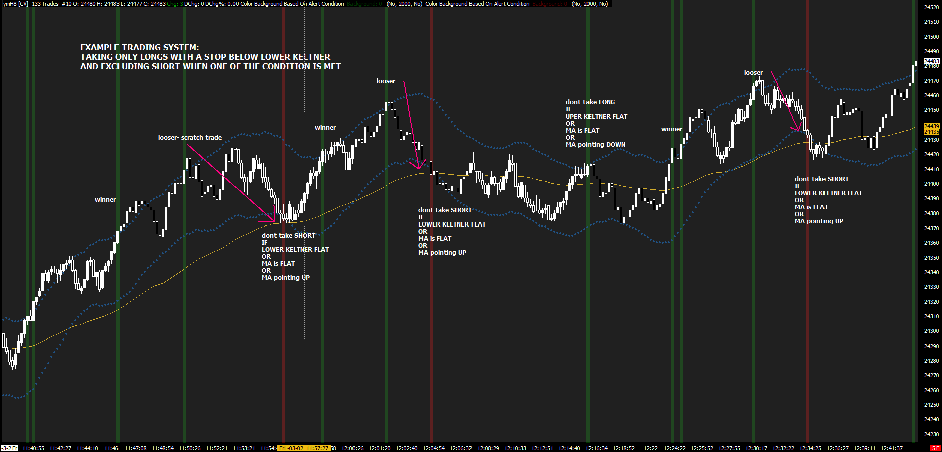

User924725 - Posts: 26
hello @tomgilb
any ideas on how we can expand the alert you gave with one more condition?
i use kelnter bands so the above code is similar
what i would like to add to the above code is taking a (long described on the conditions you gave) ONLY when upper kelnter band is pointing up.
with this way we eliminate signals taken when ketner bands are flat(RANGE MARKET) or moving down(DOWNTREND).
I tested the code you gave above. On an UPTREND is working well for a small profit BUT when we are in RANGE-Consolidation then false signals taking place.
So if we could also add the condition i asked above with the keltners the false signals are eliminating.
A good addition to eliminate more false signals would be to add a condition for a MOVING AVERAGE Based on slope. AND also set a stop for Longs taken at lower keltner and a fixed target for exit with limit order.
See below the image to give you a better idea
Keltner banks are with blue
Moving Average is yellow
AM I ASKING TOO MUCH?? :)

[2018-03-04 14:24:49]
Sawtooth - Posts: 4361
You'll need to objectively define 'flat'.
You could use the Study Angle study to do that.
You'll need an instance of it for each line.
[2018-03-04 16:08:44]
Yes i understand what you say ,
the problem for me is more that if i write each alert code individually then i dont know how to put them all together
example of a LONG alert
CODE TO TAKE THE LONG IF CLOSING ABOVE UPPER KELTNER + CODE FOR TAKE THE LONG ONLY IF UPPER KELTNER IS POINTING UP + CODE FOR TAKE THE LONG ONLY IF MOVING AVERAGE IS SLOPING UP
all those condition must be true.
and then take this alert and put it on a trading system study with a stop on lower keltner and a fixed target based on ATR .
thanks for pointing out anyway :)
[2018-03-04 17:40:33]
The conditions are actually this:
-Long when C crosses above upper Keltner (not just above)
and
-Keltner is upsloped
and
-MA is upsloped
The entire Longs code looks like this =AND(CxoK,Kup,MAup)
The crossover portion is in post#2:
AND(C[-1]<ID2.SG1[-1],C>ID2.SG1)
The Kup portion is this, where the current is > the previous:
ID2.SG1>ID2.SG1[-1]
The MAup portion is this (where the MA is ID1, edit as needed, and the current is > the previous):
ID1.SG1>ID1.SG1[-1]
Put it together:
=AND(C[-1]<ID2.SG1[-1],C>ID2.SG1,ID2.SG1>ID2.SG1[-1],ID1.SG1>ID1.SG1[-1])
