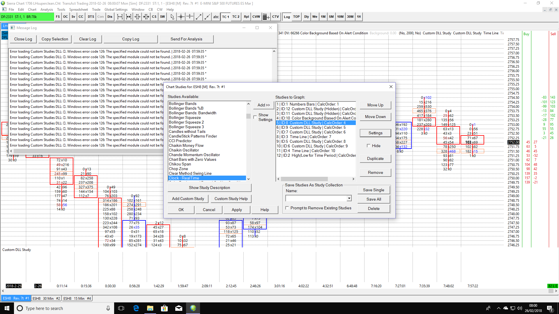

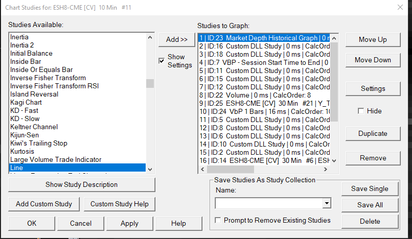

I don't think the _64 file name appending is functional in the v1706 pre-release. Pleas prefer to the attached screenshots:
test 1. showing a saved chartbook with 'missing' studies
test 2. drilling down showing the DLL name (highlighted in red) that does not have _64 appended.
You will not see it there. This is done in the background.
Based upon what we see in the Message Log there is a problem with the filename. It looks like the filename is using 16-bit characters and that is the source of why the file cannot be loaded.

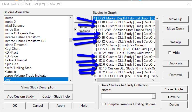

I'm on 1707 now.

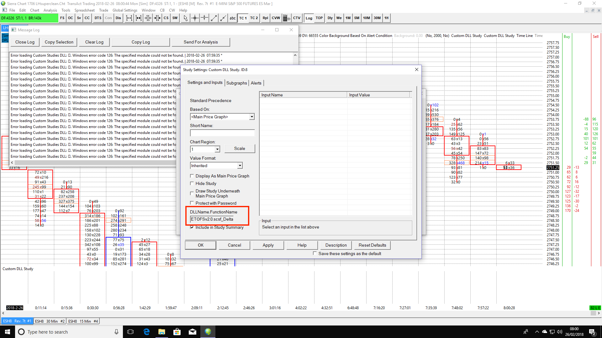

The Visual c++ compiler works fine and created a _64 version of the dlls BUT still the 64-bit Sierra doesn't automatically replace the 32-bit dlls that were applied to a chartbook with their new _64 versions (As you can see in the attached image).
Is Sierra supposed to replace them automatically or do we have to manually replace all custom studies with their _64 version manually (after buiding them on 64-bit of course).
imagestudies on 64-bit.PNG / V - Attached On 2018-02-27 13:14:53 UTC - Size: 48.74 KB - 587 views
We will do more testing on this and see why this is the case.
