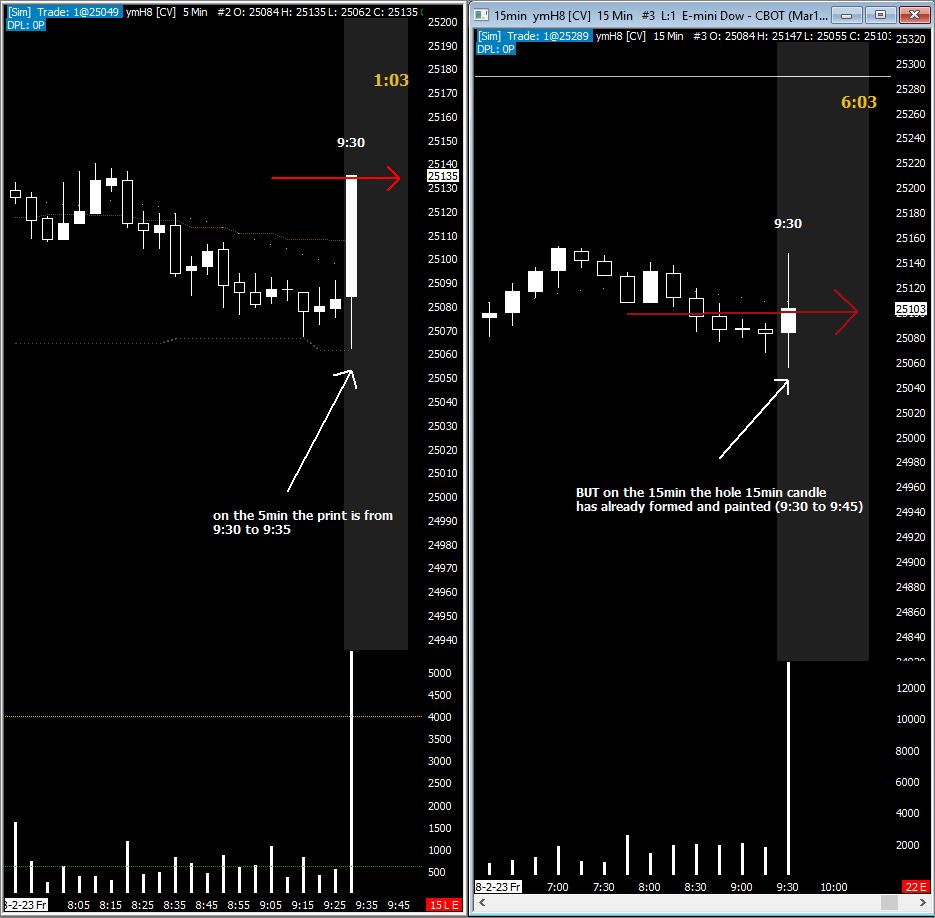

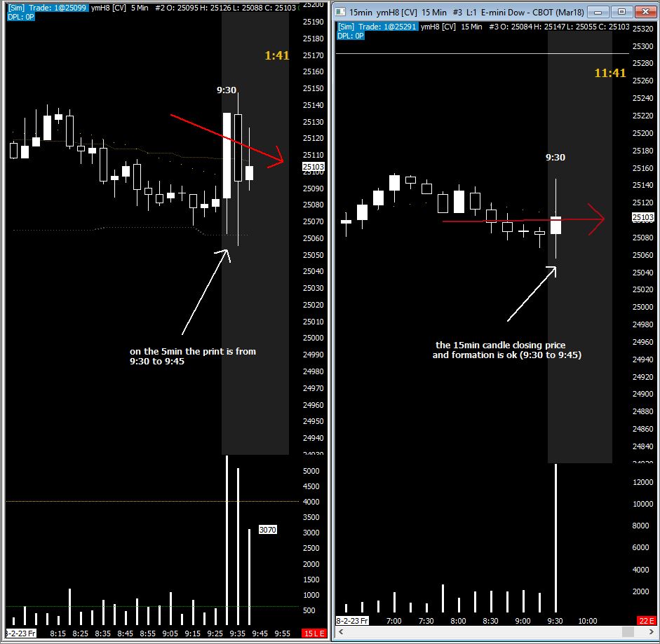

hello,
i am using 2 diferent timeframes 5min and 15 min,
the 2 charts are linked and the scroll position tab is checked on chart settings of each of the two,
I am on the last bar edge of the 5min chart (white arrow) and when i scroll by one bar instead of
viewing on the 15min chart the corresponding closing price(of that 5min candle) i get the closing price of the hole 15min candle(red arrow).
The same goes for the formation of the 15min candle.
So instead of painting the 15min candle formation and closing price at 3 stages it seems that Sierra has already painted the hole 15min candle.
Is there a way to scroll bar by bar on the 5min and see the 15min candle formmation and closing price as it should be at every step of the 5min movement?

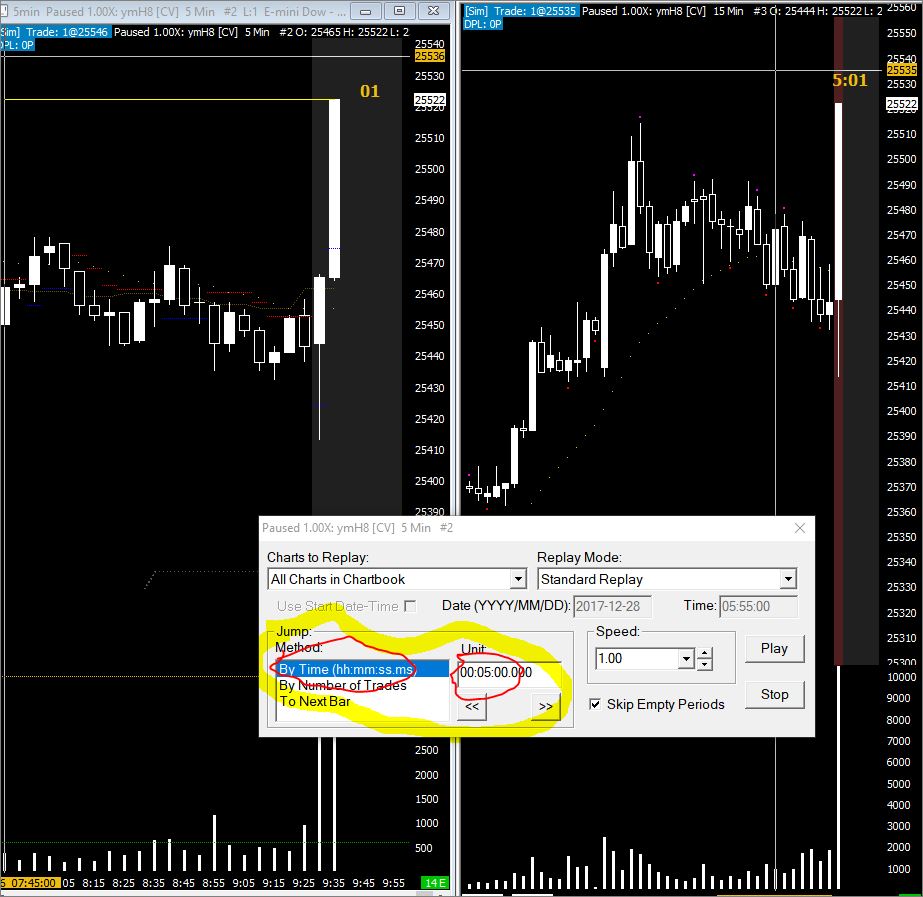

[2018-02-26 19:47:11]
User924725 - Posts: 26
Thanks Support for your help,
i found the way based on the link you sent me,
for anyone that want to know ..I should use chart replay with Jump method // By Time// and set the unit time to 5min
See attached image
imagebar by bar3.JPG / V - Attached On 2018-02-26 19:45:52 UTC - Size: 126.23 KB - 438 views
[2018-02-26 21:48:35]

[2018-02-27 18:41:39]
hello,
either i dont understand well what i should do or something else is wrong,
please if you could try to replay on your charts
2 diferent timeframe charts (5min, 15min), which are linked together with scroll potition / and try to replay with jump method to NEXT BAR using the jump forward tab
then you will see the following as a result
1> the 5min chart will move bar by bar
BUT
2> the 15min chart will form the HOLE 15min bar something that is not right in my opinion
then hit again jump forward tab one more time again and a second 15min candle will form ( but on the 5min chart total we have 2 5min bars)
So total for 5min chart is 10 minutes of bars formed but on the 15min chart total of 30min of bars formed.
The right result would be : moving the 5min chart by one bar AND GET the 1/3 of the move on the 15min chart AND NOT the hole 15min candle.
Maybe is a bit difficult for you to understand what i say because my english are not very good.
[2018-02-27 20:22:31]
We apologize. You are actually right. This is indeed how it actually works. It would jump bar by bar on both charts.
The other charts (In this case the one 15 minute chart) do not act as slaves to the master controlling chart timewise. They are going to follow the identical jump to next bar action.
Date Time Of Last Edit: 2018-02-27 20:26:16

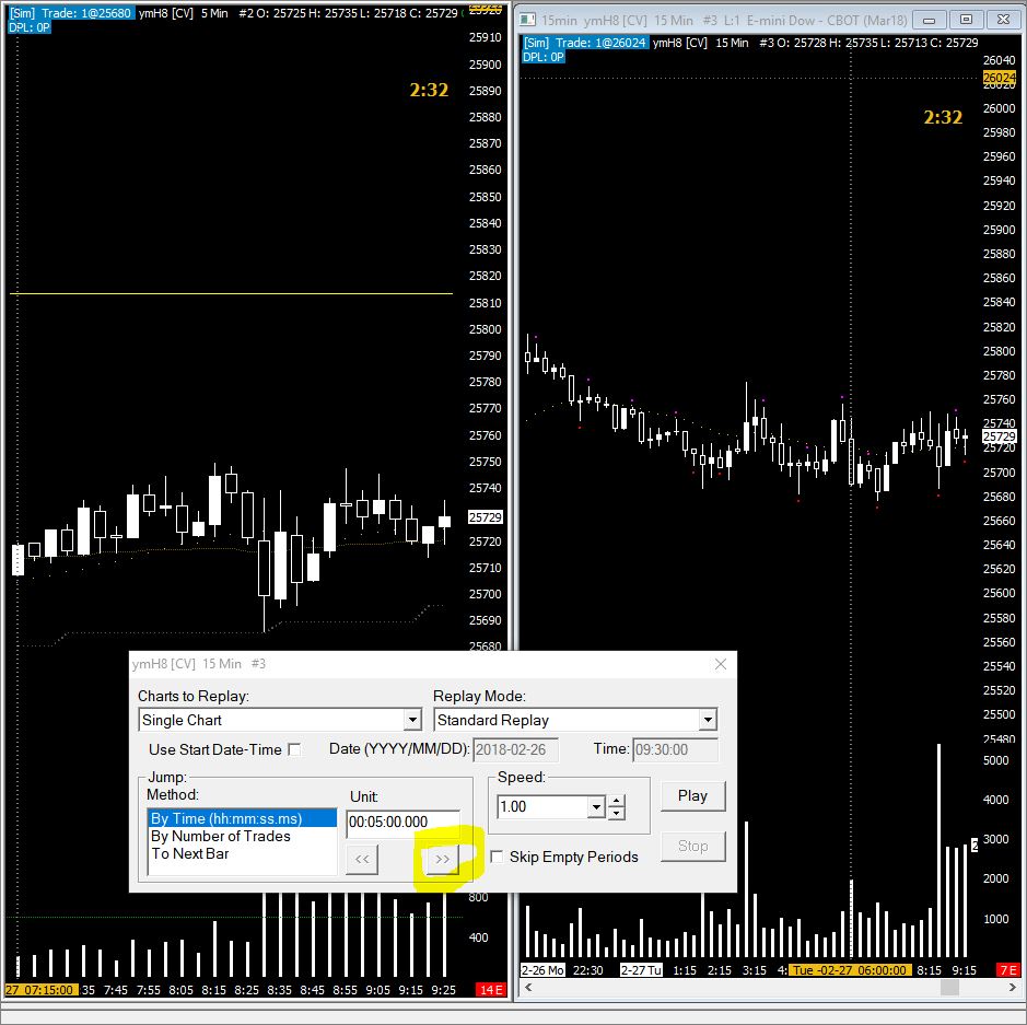

[2018-02-28 06:56:19]
ok then in the photo i send the Jump Forward button should be working but its not. (the jump forward is not enabled..and i CANT push it)
The only action i have made in this photo is that I moved my charts to the place i want the replay to start and enabled the chart replay.
You have at least hit play and pause for one time for Sierra to let you use the jump forward button.
You said that ''You can jump forward by a fixed time even when the replay is Paused'' and i am aware of this.
But you have to PLAY and PAUSE for the first time.
This is what i meant in previous post by saying (as much time it takes to hit PlAY and then PAUSE FOR FIRST TIME) ...with an unwanted result (after that)....of the candles closing on similar price but not ACTUAL PRICE.
(after that first time.... the jump forward will work as you mentioned BUT with the effect i mentioned in the previous sentence)
You will understand this if you compare the 5min chart that it set to replay mode with one 5min chart that is not in replay mode
thanks for the time you devote so you understand exactly what i mean .
imagejump forward.JPG / V - Attached On 2018-02-28 06:53:17 UTC - Size: 135.83 KB - 480 views
