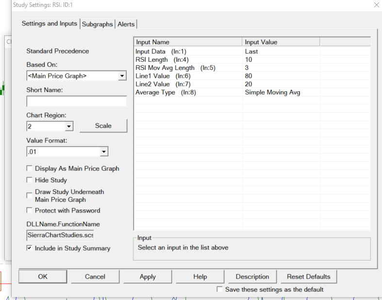

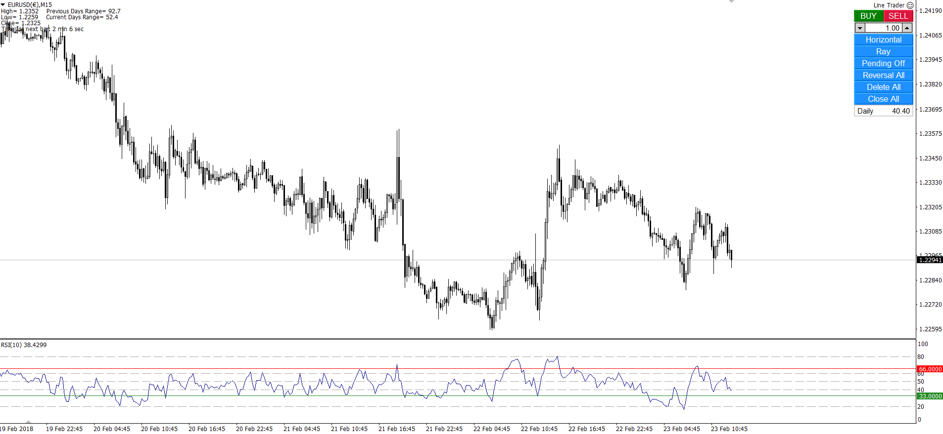

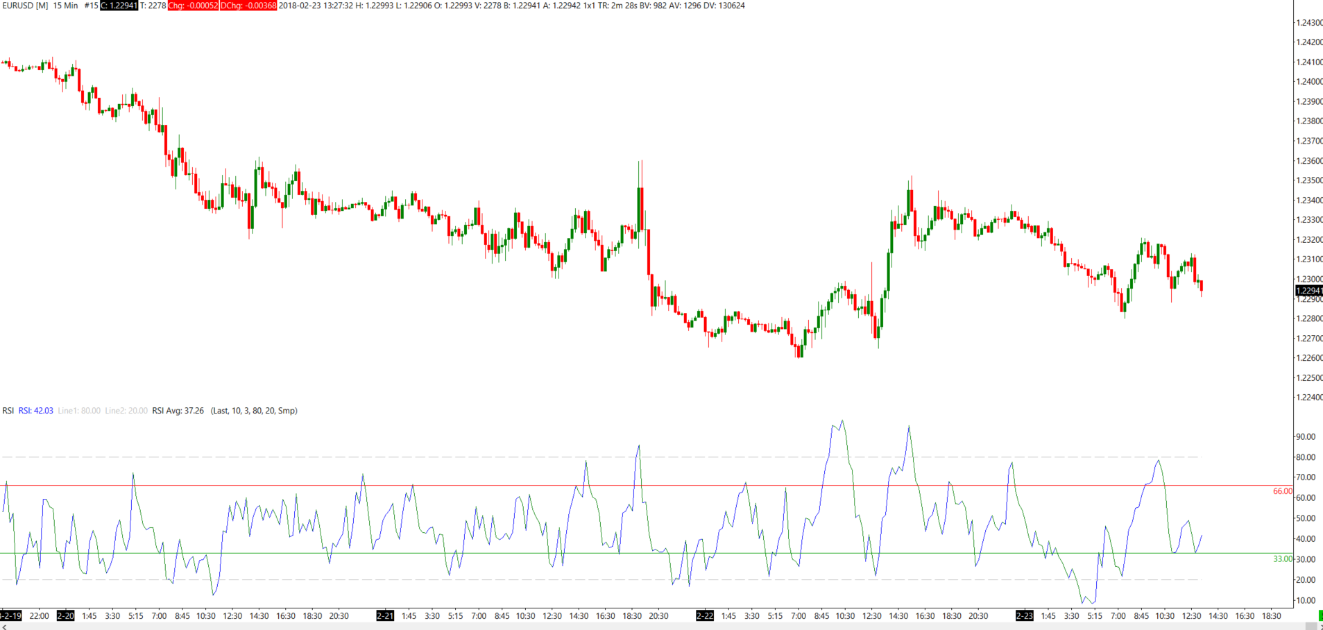

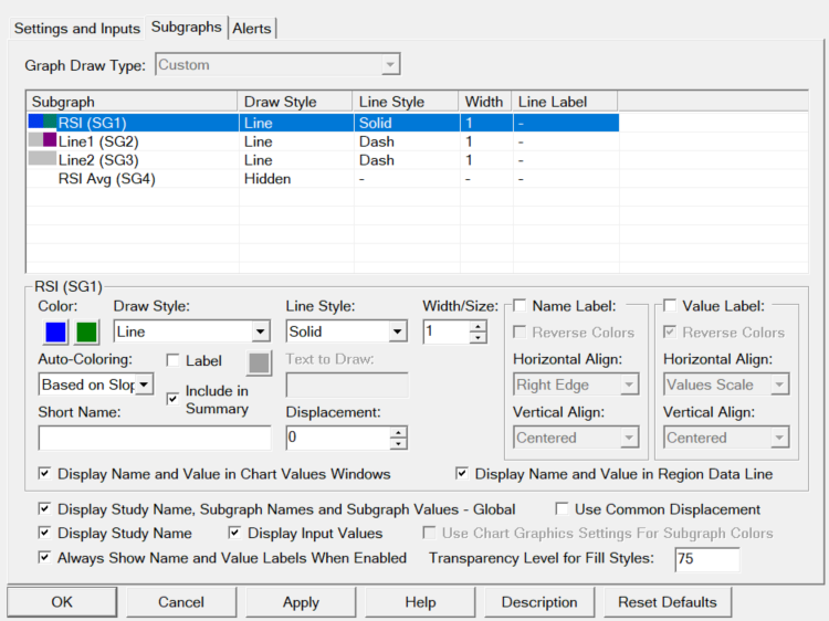

I have different readings on RSI on my old MT4 platform and the Sierra charts.
Settings are the same but the graf is different. I would like the Sierra RSI to look like the MT4 RSI. I have tried to play with the settings but have had no luck solving the problem.
imageEU_15_min_RSI_10.png / V - Attached On 2018-02-23 14:03:10 UTC - Size: 170.62 KB - 467 views
imageEU_15_min_RSI_10_2.png / V - Attached On 2018-02-23 14:03:21 UTC - Size: 110.83 KB - 411 views
imageEU_15_min_RSI_10_3.png / V - Attached On 2018-02-23 14:03:39 UTC - Size: 133.21 KB - 513 views
imageEU_MT4_RSI_10.png / V - Attached On 2018-02-23 14:03:53 UTC - Size: 48.27 KB - 501 views
[2018-02-23 18:00:26]
Refer to this section here about this:
http://www.sierrachart.com/index.php?page=doc/ChartStudies.html#ResolvingStudyDifferences
We recommend trying different Moving Average types (Average Type input). Refer to the documentation here:
RSI
