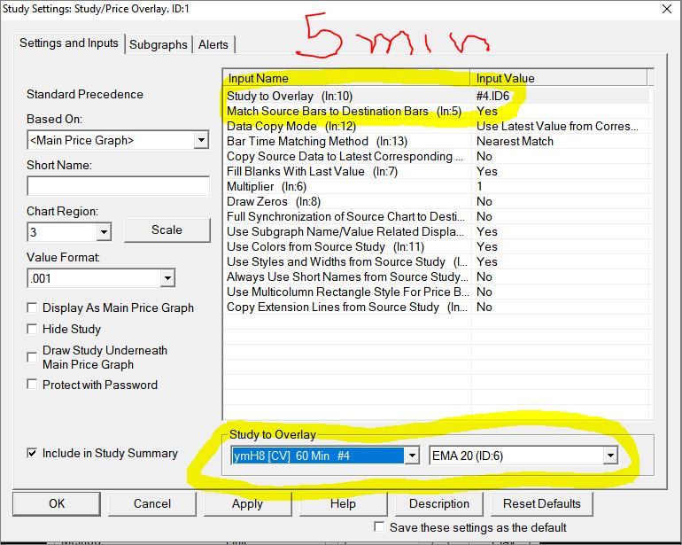

User924725 - Posts: 26
By your descriptioon the 10 bar moving average that you added on the daily should overlayed preciscely on the 5min
I assume that the study you said you are ''writing'' on the 5min chart is the study price overlay and you have set it similar to photo
The example in the photo is overlaying a 20EMA of a 60min chart to a 5min chart
Date Time Of Last Edit: 2018-02-28 07:18:00
imagePrice study overlay on the 5min chart.JPG / V - Attached On 2018-02-28 07:13:46 UTC - Size: 109.71 KB - 482 views
