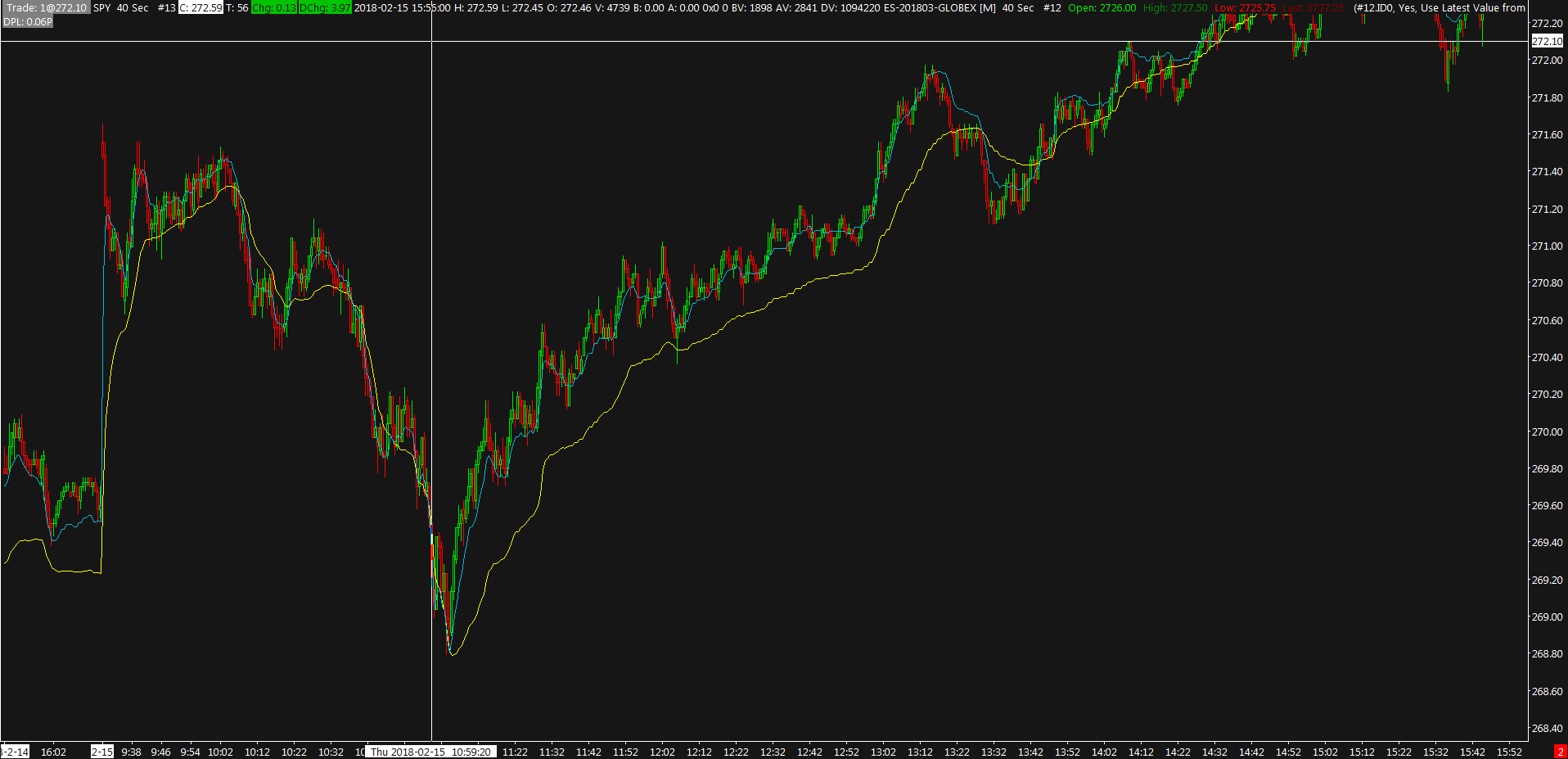

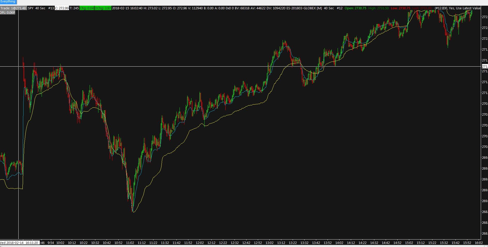

I'll attach a screenshot, but basically I followed the instructions and for some reason my two moving averages from the source chart aren't displaying correctly on my destination chart. When I put them both in Chart Region 2 beneath the main chart, they display correctly with all the crosses in the right places, but then when I move them up to the main chart they go all wonky. The yellow line is a 34 EMA and the blue is an 8 EMA.
My destination chart is a 40 second SPY chart that already has an ES chart overlayed from a different source chart. I have the SPY candlesticks turned off and I have full synchronization turned on, that was the only way I could get ES and SPY to match up properly.
http://www.sierrachart.com/image.php?Image=151875044794.png
imageMA Off.JPG / V - Attached On 2018-02-16 03:03:24 UTC - Size: 151.72 KB - 363 views

This is simply a scale problem.
Refer to:
Chart Scale and Scale Adjusting: Maintaining Same Scale for Multiple Graphs in Chart Region
