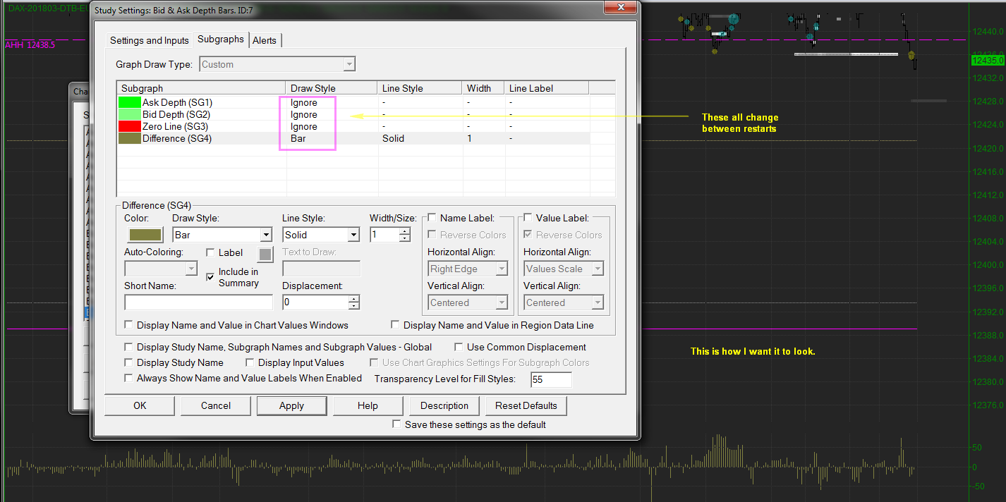

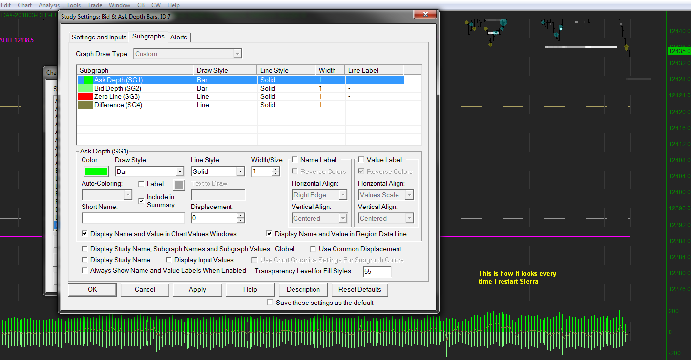

There must be some confusion between us on what I am trying to say is the problem. Please see the attached images.
imageMK-2018-02-16_154101.png / V - Attached On 2018-02-16 02:44:00 UTC - Size: 91.3 KB - 477 views
imageMK-2018-02-16_154237.png / V - Attached On 2018-02-16 02:44:08 UTC - Size: 86.15 KB - 456 views

We understand the reason for the problem. This study does automatically set Draw Styles.
Date Time Of Last Edit: 2018-02-16 03:34:46
