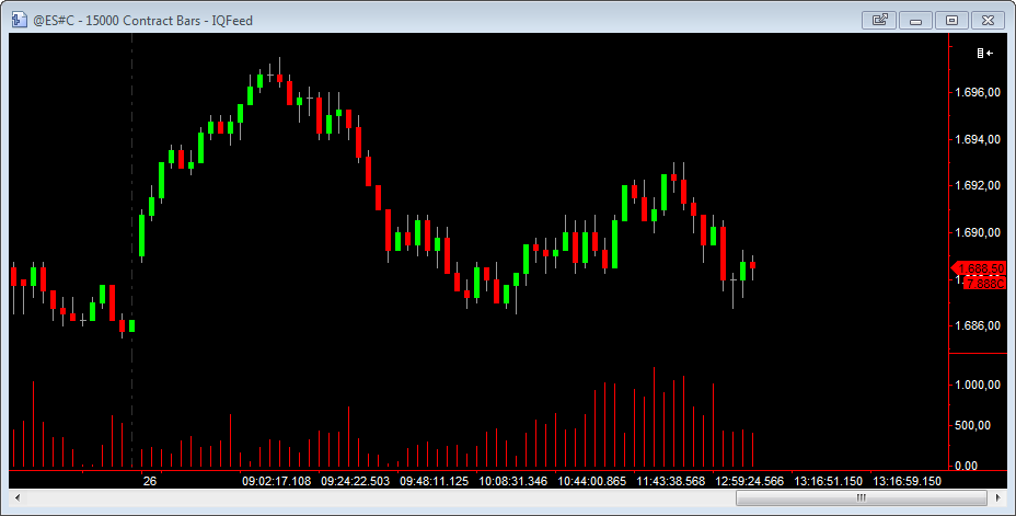

Is there an indicator that allow us to plot the time it takes each bar to complete as a histogram?
Basically would be something similar to the Bar Duration on the Numbers Bars Calculated Values does but instead of plotting text it would plot a histogram like the attached image.
This is very useful to pick up some divergences between time and price/volume action.
A rallie showing 15k bars that are taking too long to fill indicates not much interest at those prices which might indicate that a pullback, initially, will search for new buyers capable of continuing the rallie.

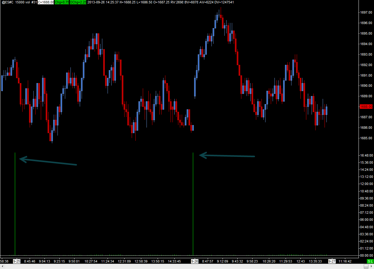

trademechanics - Posts: 29
Many thanks Marmany.
It seems to suffer from the same problem that the Numbers Bars Calculated Values suffer which
Sierra developement already said they have no interest in
odd bar duration on the last bar of the day using the numbers bars calculated values study
Although on the number bars the issue is not that important, when on a histogram, well, these spikes makes the study useless when we zoom out and show several days :(

M5amhan - Posts: 468
yea, those spikes happen because the study is calculating from previous close to close instead of current open to current close

We do plan to get to resolving this with the Bar Duration study as soon as we can. It is not simple. Working with time, these things get very complicated.

Marmany - Posts: 319
For info I use Bar Time Duration on tick charts, printing bars in 45 +/- 30 sec. Set use Max duration = Yes, Max Duration = 00:02:00 gives a histogram which is not "damaged" by spikes and suits my purpose very well.
