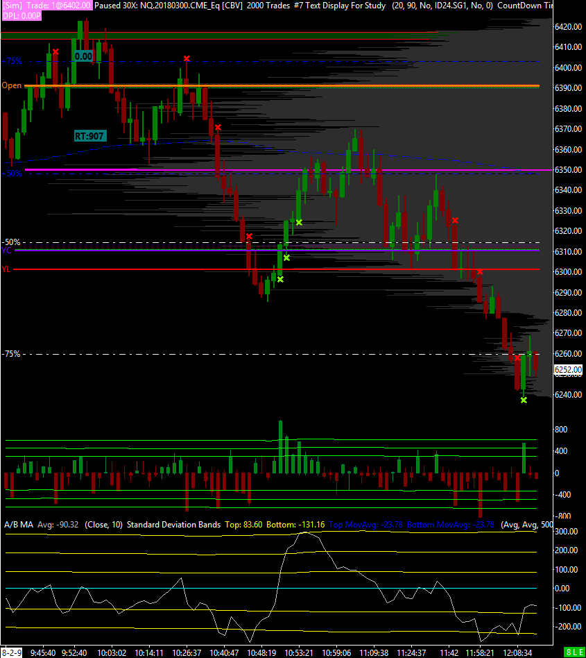

Hi, please see attached. I've allowed my chart to run about 30,000 trades but I do not have the option to jump back with 6000 units as per configuration. I can jump forward, but not back, although enough trades have passed to justify a jump back.
Any ideas?
imagePaused 30X NQ.20180300.CME_Eq [CBV] 2000 Trades #7 2018-02.png / V - Attached On 2018-02-11 04:49:30 UTC - Size: 54.77 KB - 614 views
[2018-02-11 16:17:13]
This is not supported and will not be.

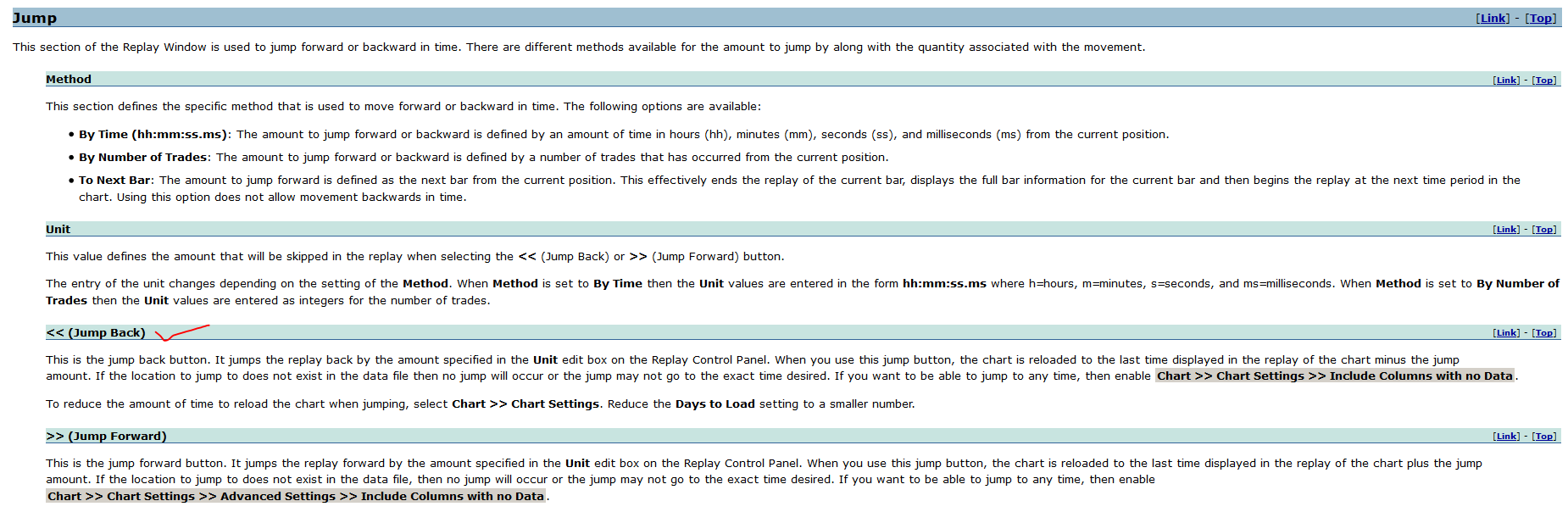

Your comment does not make sense. Your documentation is quite clear that this is catered for: Replaying Charts
See attached
imageJump Back.PNG / V - Attached On 2018-02-12 04:05:33 UTC - Size: 63.4 KB - 510 views
[2018-02-12 04:39:37]
It is supported to jump back by fixed amounts time, not trades.
[2018-02-12 05:04:56]
User172040 - Posts: 70
Ok, but that is not clear from the docs. Maybe that should just be clearly stipulated then. I can jump forward by fixed amount of trades so my logic stated that it should be possible to jump backwards as well. Thanks anyway
[2018-02-12 05:58:53]
Documentation has been updated. It was an oversight, that it indicated generally that jumping back was possible by any of the methods.
