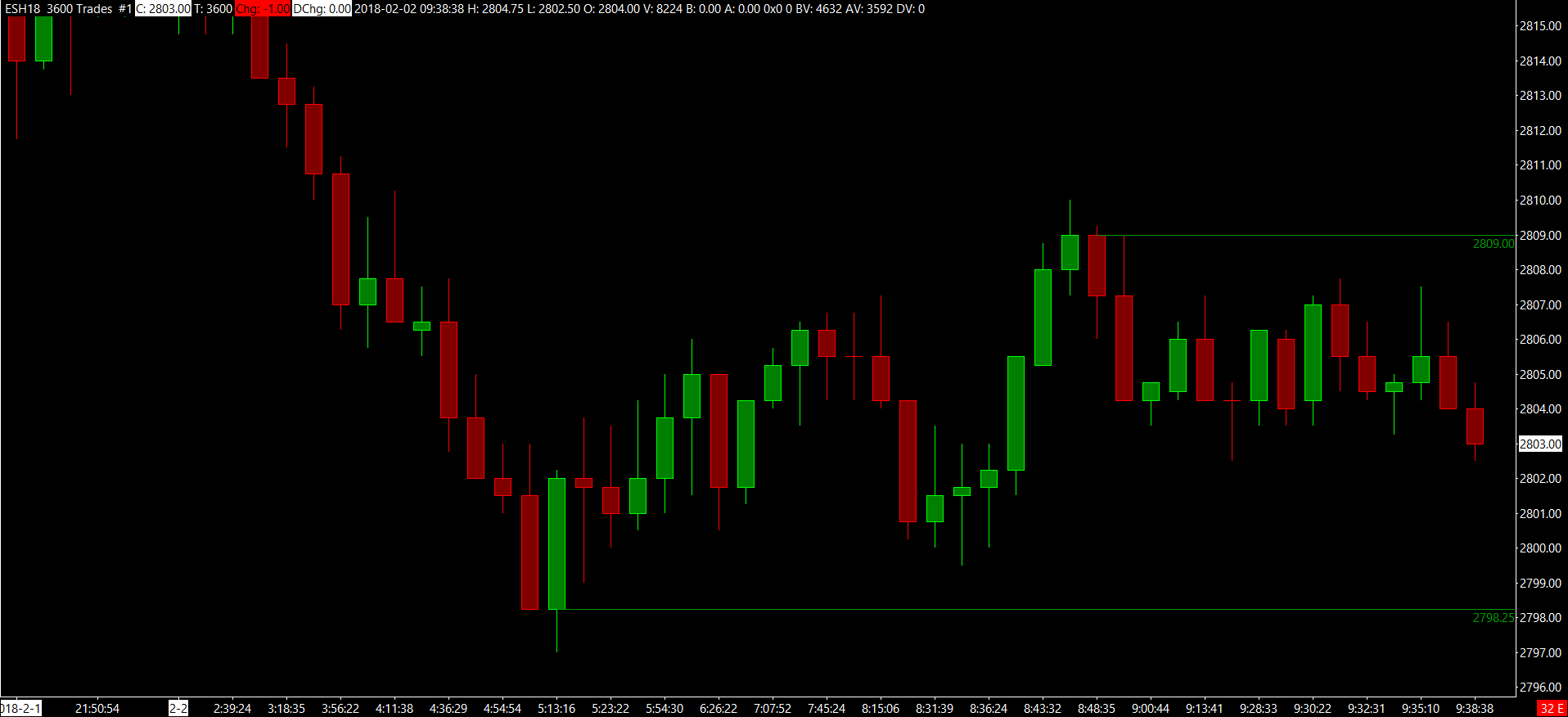

Do you know the reason ? Here is the link of the chart today.
http://www.sierrachart.com/image.php?Image=1517586768904.png
You can see the 2 Yellow Lines on the left Side: One is at 2798.25 (the close of the Overnight bar on downside) and One Yellow Line on the above at 2809(the close of Overnight bar on Upside). These numbers should have been 2809.25(upside) and 2798(downside).

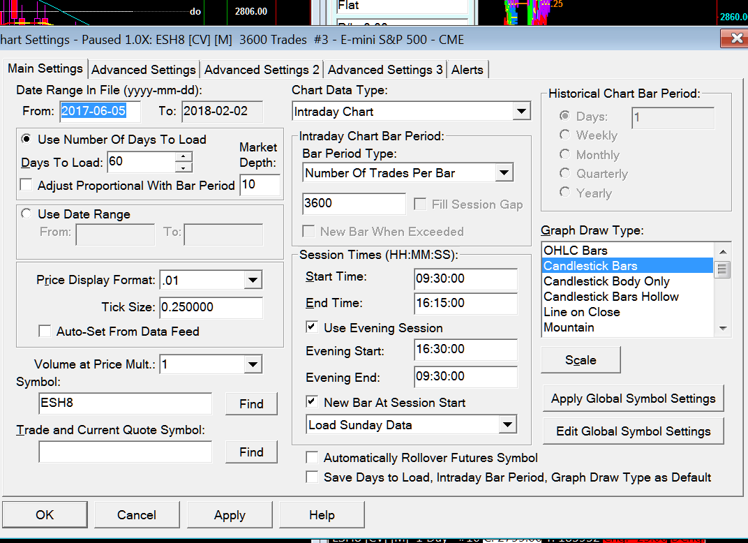

Here are my settings in the chart for the Overnight Trades:
imageChart Settings.png / V - Attached On 2018-02-02 16:04:37 UTC - Size: 120.16 KB - 512 views

This probably will not change anything, but set the Evening End Time to 09:29:59
Also New Bar at Session Start is only going to start a new bar once a day. Not at each session. Refer to:
Chart Settings: New Bar at Session Start (Chart >> Chart Settings >> Session Times >> Intraday Chart Session Times menu)

Nope nothing helped. I tested setting both "New Bar Session Start" or Setting the evening time to 09:29:59.

We see the same information you are seeing in your Sierra Chart given the same chart settings. We have an open price of 2798.25 for the bar at 5:13:16 and an Open price of 2809.00 for the bar at 8:48:35.
Here is a screenshot showing the same information.
http://www.sierrachart.com/image.php?Image=1517857459964.png
