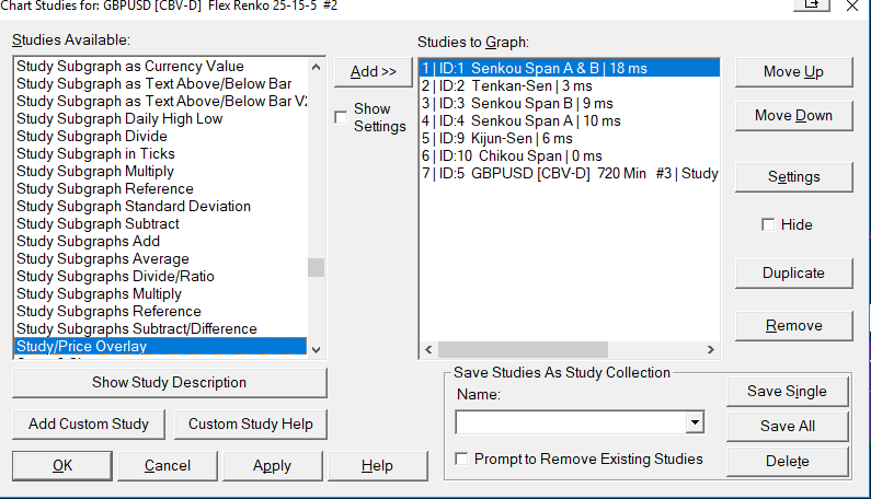

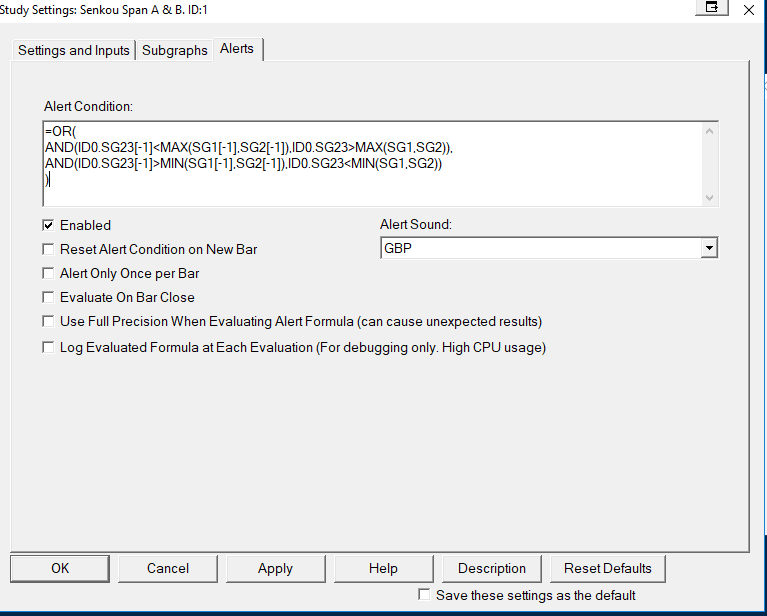

Im not sure what Ive done wrong here. It wont fire on EURUSD or GBPUSD. Attached are my settings for GBP
I haven't changed the code at all.
http://www.sierrachart.com/image.php?Image=1517411289262.png

Sawtooth - Posts: 4361
Use this formula instead:
=OR(
AND(CROSSOVER(ID0.SG23,ID1.SG1),ID1.SG1>ID1.SG2),
AND(CROSSOVER(ID0.SG23,ID1.SG1),ID1.SG1<ID1.SG2),
AND(CROSSOVER(ID0.SG23,ID1.SG2),ID1.SG1>ID1.SG2),
AND(CROSSOVER(ID0.SG23,ID1.SG2),ID1.SG1<ID1.SG2))
Apparently the MAX and MIN functions don't always work in Simple Alert formulas.

grantx - Posts: 244
Wasnt working for me no matter what I did so I added Senkou SpanA and Senkou SpanB studies separately and then referenced them instead.
Now its working!
Really appreciate your help tomgilb.
