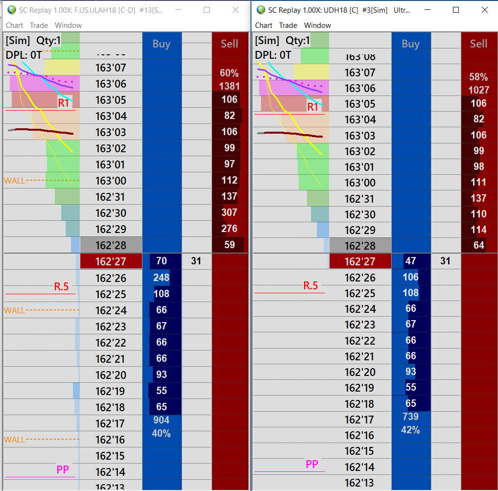

Logan W - Posts: 28
I saw in a similar post that you had provided the market depth files from the Sierra Chart data feed.
I loaded up the files and put a CQG feed DOM (left) and a Sierra Chart feed DOM (right) side by side.
As you can see, there is a large difference between the market depth figures being displayed, as shown in the pic attached below.
This is not a time-stamp issue because the CQG feed depth figures are Never shown on the Sierra Chart feed DOM.
Why is there such a large difference between them? Which one is correct?
Also, both data feeds experience the same jumpiness and bid/ask spread issues. No efficiency improvement with the Sierra Chart data feed over the CQG feed during replay mode.
Another indication that is is not a time-stamp issue.

[2018-01-24 18:05:45]
What Sierra Chart is providing is definitively correct with what you see during real-time updating. When you start a replay of market depth, it may not be correct until up to 10 minutes later:
https://www.sierrachart.com/index.php?page=doc/ReplayChart.html#UpdateFrequencyOfReplayedMarketDepthData
If you see differences compared to CQG data, then the CQG data is not correct. This we know with certainty. We are providing the exact same data provided by the CME multicast data feed. If CQG is building market depth by the market by order data, then inherently it can be inaccurate and we know that from experience with working with that type of data.
We never saw any evidence of the last trade price being out of sync with the bid and ask prices with the data provided by the Sierra Chart Exchange Data Feed. We had thought that is what you were referring to.
If you only see a single update within the span of one second this would be considered normal. We do not know what you mean by bid/ask spread issue.
Refer to:
https://www.sierrachart.com/index.php?page=doc/ReplayChart.html#UpdateFrequencyOfReplayedMarketDepthData (Update Frequency of Replayed Market Depth Data)
Date Time Of Last Edit: 2018-01-24 18:08:09
